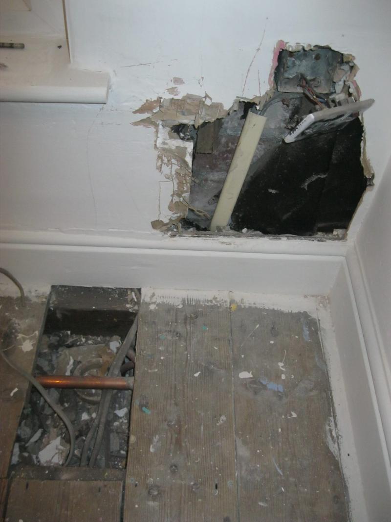

I have had a look around the single socket and kind of looks like 1 big mess now, lol although only cosmetic

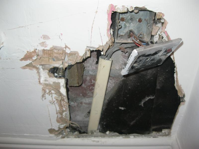

At some point this part of the wall under the single socket was taken off because the plaster job to cover it again was a joke, so I don't mind that this has now all come away, at a guess I would say this is the first socket in the ring and the red/black wire comes from the CU

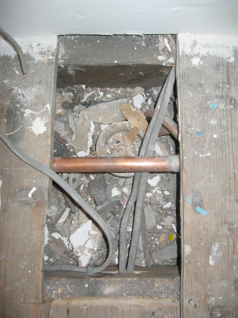

You can see the wires entering the room, this is immediately above my CU that is in my hall as this bedroom is above my front door

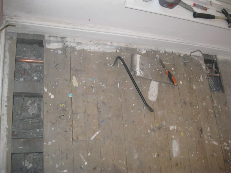

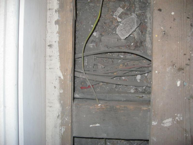

This is where the feed comes into the room from the CU
'Taking' a cable off a ring can only be done under certain conditions though, so testing the circuit will confirm which option you should take.
As you have gathered now, a visual look will not always confirm what you need to know, as well as causing a load of mess.
Removing that plaster has shown that the old cables are not in a safe zone, they are not directly in line with the socket. So you should take the opportunity to get them in line.
It may make sense to make the old socket a double, but until you can confirm if a ring or not we cannot really advise if you need to fit a FCU, or even get a feed from somewhere else.

Am not surprised the council would put wires outside of safezones, more work for me I guess!

What your relative said has no bearing on what has been said above. You need to prove it's a ring before you take a spur from it.
And as said you need to move the cables to a safe zone.
