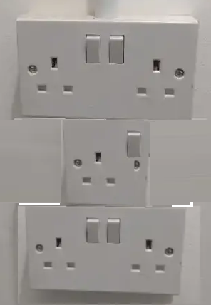

Do I need conduit in this case?
but the op could just take a small nibble out of the bit on the side and marry it up alonside another pattress then the cables wouldnt be seen/exposed
Yes indeed, I imagine OP would prefer to purchase products matching those already fitted and therefore a nibble out of both patresses will suffice, as will drilling a hole as discussed.
Personally I'd drill with a step drill as they make a lovely clean and acurate hole in patress material and the next size cut creates an excellent de-burred finish, in my opinion no further action is required if the 2 boxes are butted tight together

Do you have space to fit a double socket beside that? From the vertical paint finish it looks like there is an edge to the left.
I do not have space at the moment. Light switch is on the RHS and Electrical Cutout is on the LHS.
To do the job, I would have to move the light switch.

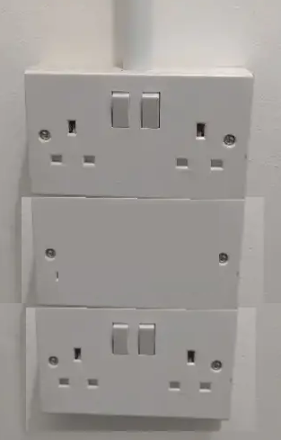

In that case for simplicity it may be better to go back to plan A and add the additional socket above or below, with a gap about the size of a socket, using a short length of couduit or trunking. Or possibly a 3rd patress with a blanking plate.
This will reduce the obstruction by leaving plenty of space for cable route
Genius! I like this a lot...
So that's how you overcome the lack of clearance if you cannot mount to the side and don't want to use blanking plate. Brilliant solution.

The job needs to be done 'right' (even if nobody else will see or appreciate it). Will either chase the wall or add more conduit.
For a start there is noting wrong with the suggestion of 3 extra other than it'll look unusual, it will however provide a practical solution to the issue.
I'd assess your usage before you start knocking holes in the wall. Are any of the regular plugs wallwarts, particularly with cable exiting the top or side?
The main problem with butting 2 sockets together is the bend radius of 3 core flex, fouling the lower socket, particularly in moulded plugs which usually have an external strain relief. IIRC already mentioned.
So look at what's got to be permanently plugged in before you jump.
