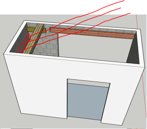

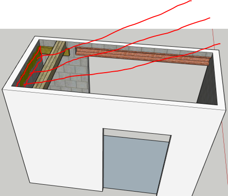

Now that i have fully set out the lines from the existing roof down the rafters will sit as below if they are run through and not into a valley rafter. Is that better/easier than the valley rafter. I will be ordering the material this week so wondered what way to go.
The triple timber beam on your picture will potentially be taking a lot of weight (think snow load), you’d need to get a calc done for it and build it in, I’d be v surprised if you can just sit it on top of a timber bolted to the surface. But as above, surely the valley rafter is the way to go and avoid having to worry about it.

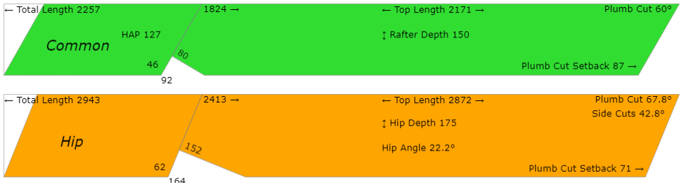

Timber has just been delivered ready for me to make a start on the roof at the weekend. I have found a handy website that calculates the rafters and depths etc for me to use but nowhere seems to do the same for valley rafters.
Is the valley rafter the same as the hip from the adjacent corner? They both run from the same ridge point to the wall plate in the same direction? This is the last piece i need to get my head round before i start the work.
Section over the garage above. The valley rafter needs to then link in to the right. Would it be the same as the yellow hip rafter shown above?

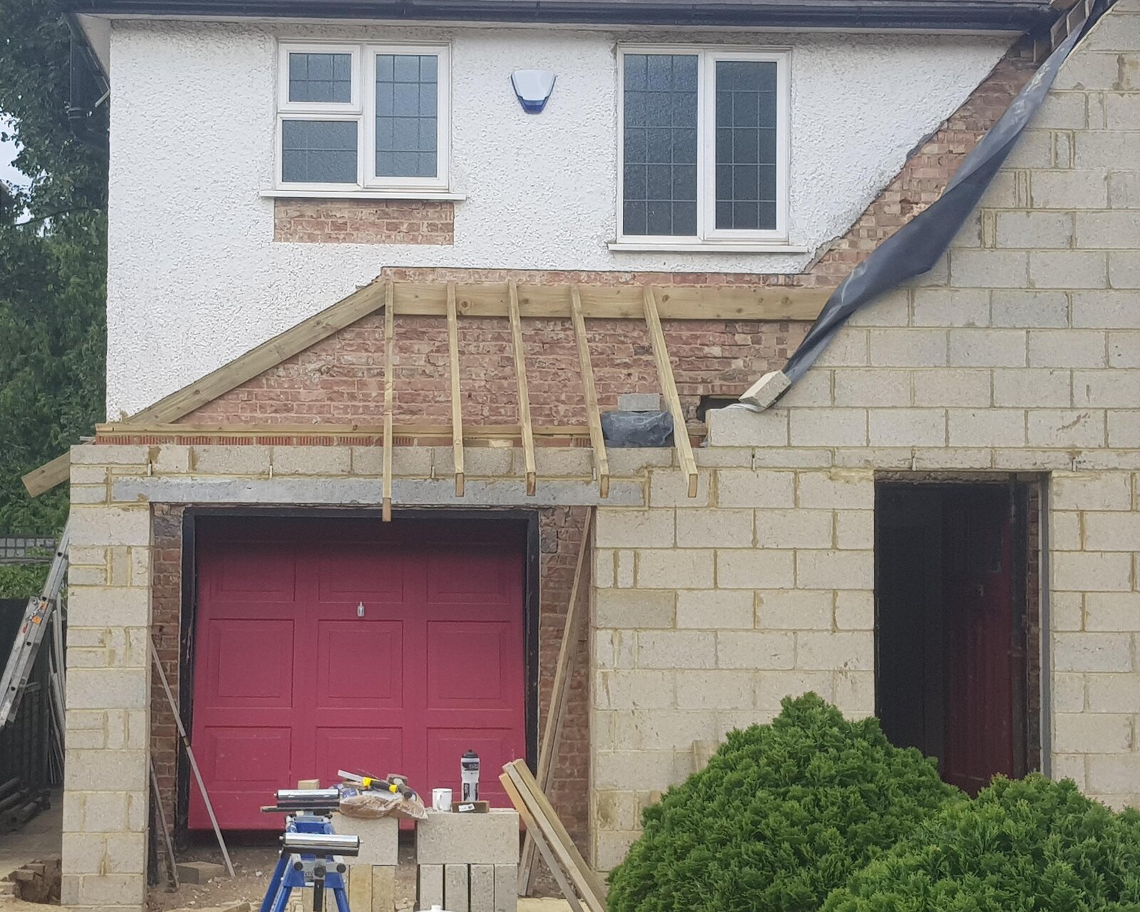

I had about 4-5 hrs on the roof this afternoon. I got the lifted wall plate fixed down and then managed to get all of the common rafters cut and in place. Made a jig for the scribe round the outer skin of brickwork that worked well but measured marked and cut each of the rafters individually. Thoroughly enjoyed this and it was far easier than i had expected (i know i have the hip and jacks left which will be more complicated).
I was concerned that everything needed to be mm perfect but then as i was going realised this is not possible as each timber was different, each rafter was hand marked and cut free hand but when it all came together i think it came out a treat.
I have only fixed each rafter with 1 nail at top and bottom in case you guys point anything out that needs to be changed. If you think it looks ok i will fix them all in the morning (3 nails to each top and bottom?) and then move onto the hip and jacks.
I left the overhangs oversized so that i can get an accurate string line from the blockwork and cut them all once finished.

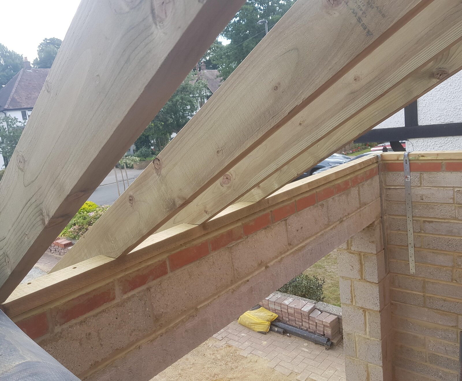

The calculator i used allowed for a fillet above the higher wall plate. I didn't realise this which is why the rafters finish above the board. Is this actually needed or will the tile just fly past?
Is a course of bricks to the outer skin between the rafters required? I assume so.
Thanks for all your help. Still need to get my head round the valley . . . .
Whats holding and restraining the rafters at the top to prevent them sliding?? And they don't look like they are against the wall, how will the top tile batten be fixed?
(You would normally fix the ledger plate below the rafters so that they sit on it, and it only needed to be a 4x2, and then the rafter peak sits against the wall)
Is that end rafter spaced differently?
The cuts look nice
You may want to strap that plate down centrally over the door opening befor you start banging with the roof tiles
