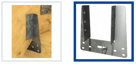

The rafters are nailed to the ledger plate using 90mm collated nails. I thought this was common practice - Is that OK

BCO might want some kind of truss clip type thing at the rafter tops as theyre not sat atop the plate as woody says

This sort of set up?
Do you think this will be an issue? All the research i did most nailed back to the board.
I was thinking is there any sort of clip i should install at the bottom where the birds mouth is similar to the image above
No it's wrong. There is potential for the rafter to be pulled outwards, let alone the fact that vertical load is reliant on a couple of nails - unlike seating the rafters on top of a ledger board.
You should fit some brackets as per 23cv to restrain each rafter. Right angle brackets will do, instead of truss clips.
So right angle brackets fixed to each side of the rafter and back into the ledger?
