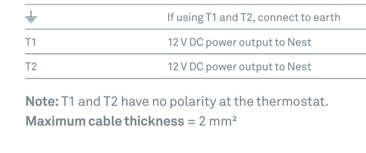

From the installation guide...
although, there's wasn't an earth connection on the gen two Heatlink.

or another supply, when supplied from the heat link an earth is required, however 411.3.1 states "A circuit protective conductor shall be run to and terminated at each point in wiring and at each accessory except a lamp holder having no exposed-conductive-parts and suspended from such a point." so you still need an earth to the heat link, even if not used.
