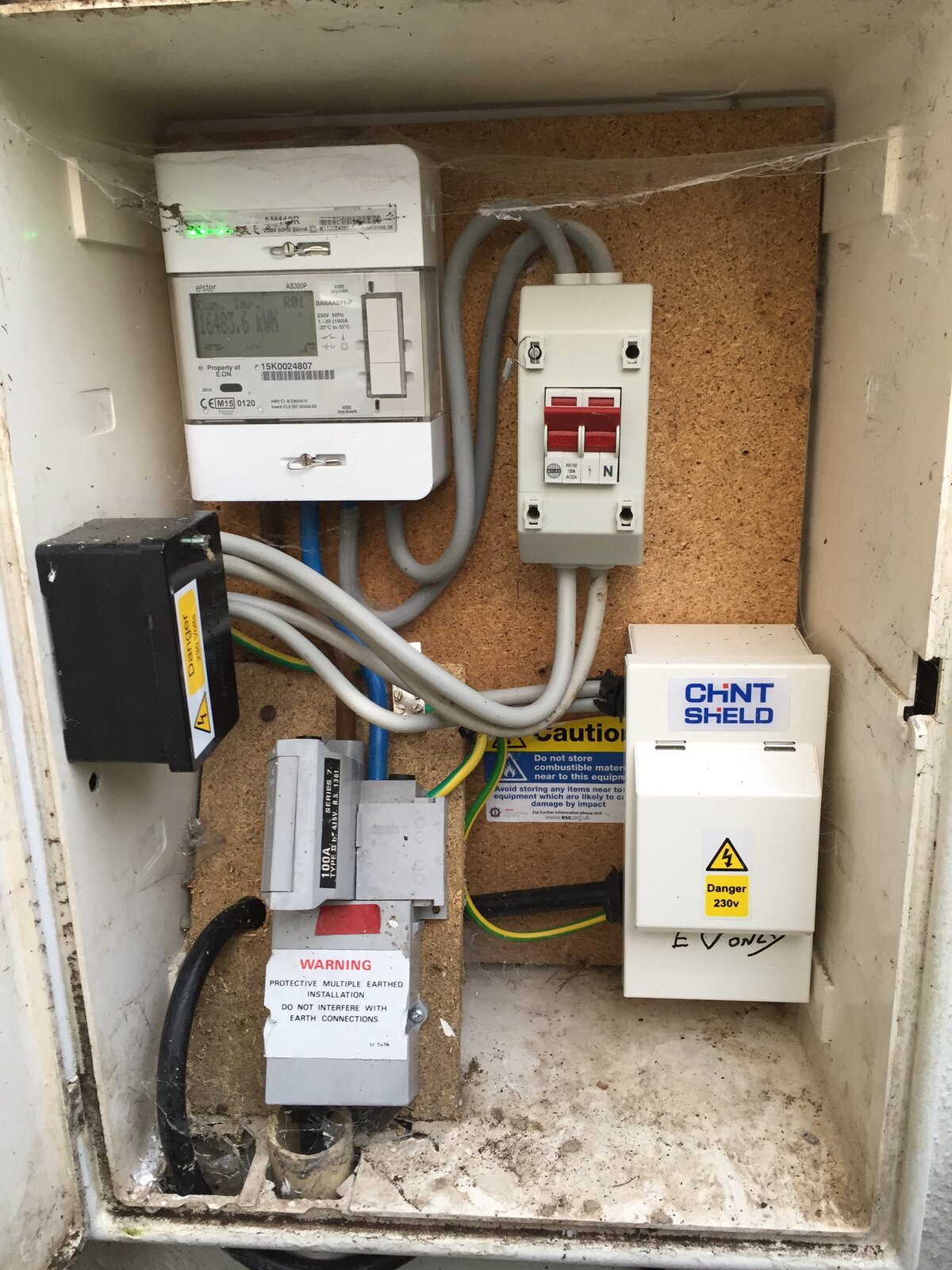

How is this electrician proposing to fuse down the swa, given you wrote " splitting the heavy supply cable to Consumer Unit"? is there room for a switchfuse in the meter cupboard? Hope he wasn't expecting to just join it directly to the cu tails.
He said there was room in the Meter Box to put a splitter (it had a name which I forget) and that he'd run 4mm2 armoured. Now you mention it, it did cross my mind this wouldn't fuse the armoured run before the garage box, except for the 100A main fuse(!) What should he do there? Think he was looking for a way to avoid running a cable indoors under floorboards and all that upheaval.
Henley block? There should be some kind of down rated fuse or small enclosure
Something like this with a smaller fuse.

View attachment 256123 As posted, should look something like this when done correctly!
Tails split using henley blocks, then a switchfuse or 1way cu installed with the swa correctly terminated using the correct glands.
Note - Pic for illustration only!!

Nothing in BS7671 states that cables must be buried or otherwise. Cables must be suitable for the environment they are installed in.
Meter cabinets are for meters and DNO equipment only, they are not intended for other devices such as switchfuses or grotty little consumer units.
Cables require overcurrent protection, so just connecting in with 'henley blocks' won't do, and you can't connect armoured cable directly to such things anyway.
