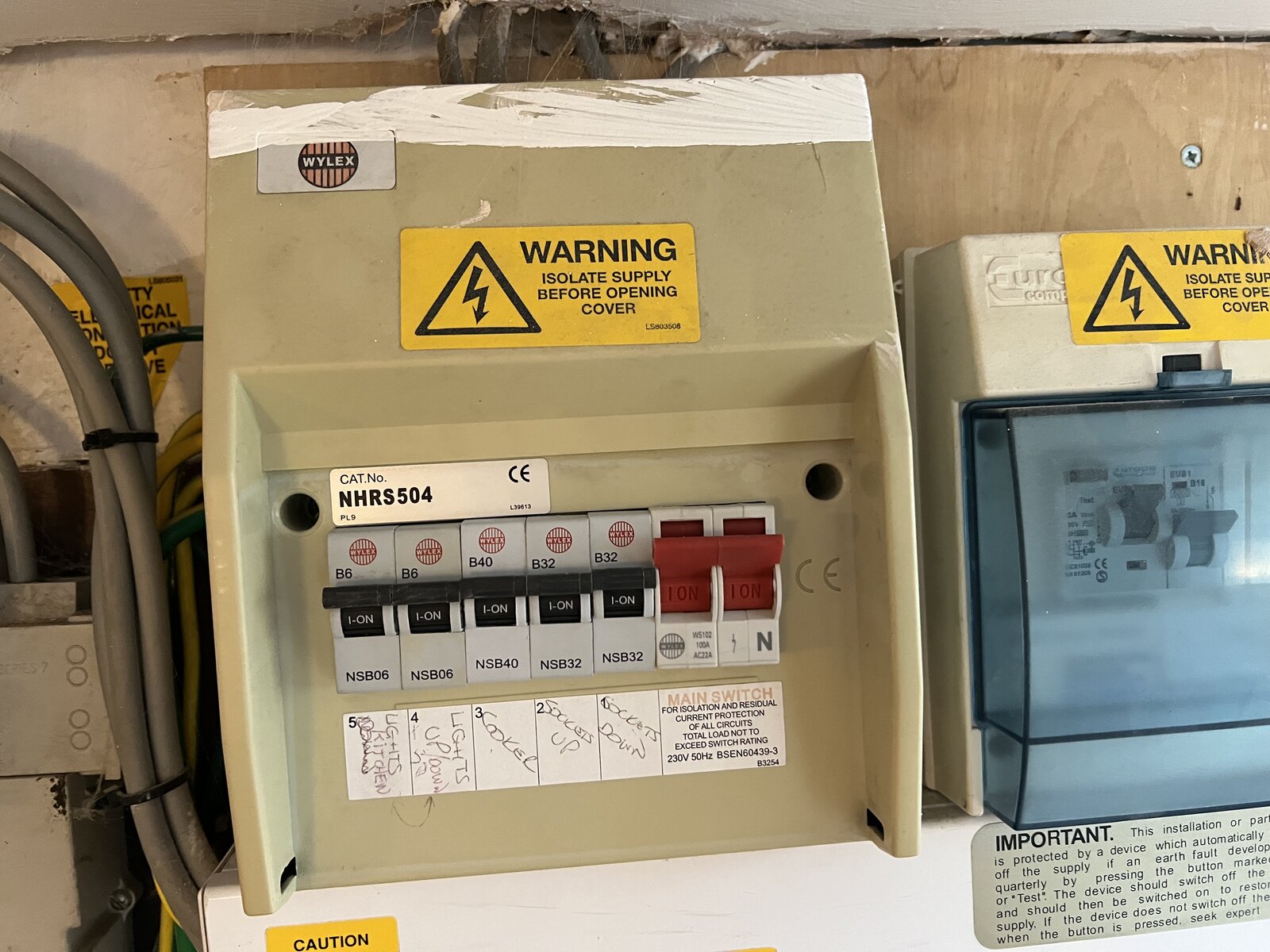

Hi. Electrician said my unit doesn’t have RCD and can’t do further work without upgrading it—is this correct?
Simple answer is yes he is correct. There is nothing stopping you using what exists, but can't add.
The are ways, use of SWA cables, Alitube cables, and RCD sockets etc. but likely will cost more than a new consumer unit. But unit to the right does have a RCD, so why not use that one?
Which work can't he do without upgrading it?
He is unable to make any changes to A circuit without bringing THAT CIRCUIT up to current regs. If he is only working on one circuit he may be able to transfer it to the second box.
But to be honest the difference in the amount of work involved upgrading one circuit and replacing what you have with a new Consumer Unit is normally not significant.

the RCD to the right is for the solar panels apparently
i asked if he could remove some plug sockets and install new ones

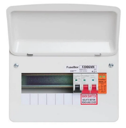

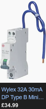

Around £130 for a fusebox CU with SPD and isolator, and 5 RCBO's and likely ½ day to fit it. Labour costs vary so much, hard to guess.

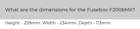

This is the bit not so sure about, will it fit?
It is larger 1731321424265.pngas 6 way not 5, and also two ways for SPD and the MCB that feeds it. Maybe one can just fit RCBO's?
and keep the existing CU? That will cost more in parts, but less in labour, so ask your electrician as to cost.
