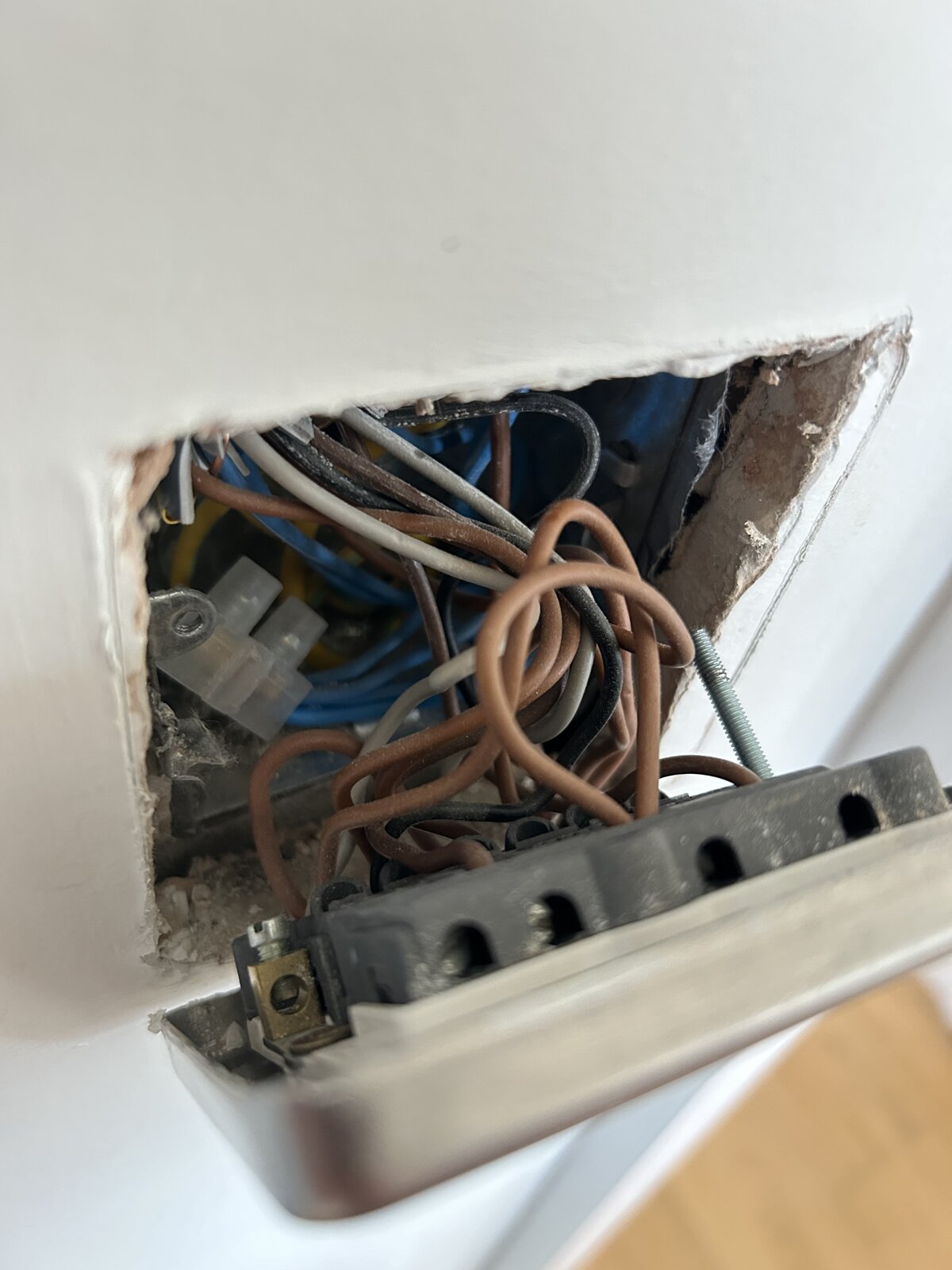

Hi Colin
3 hours later and I’m struggling and I haven’t had a brew yet….!
I’ve bought a new socket, connected all the live wires but can’t fit all the earths into the faceplate Earth terminal. I also now can’t get them all into the Earth at the back box as it’s too fiddly..!!
Can I split them and put some earths to the back box and some to the faceplate? Or do they all have to terminate in the same place with a fly lead to the other Earth terminal?

Further to your post - if I terminate all the earths in a 30A (30A is all I have in the garage) choc block, then run an Earth from this to the back box and another from the block to the face plate would that suffice?
John Further to your post - if I terminate all the earths in a 30A (30A is all I have in the garage) choc block, then run an Earth from this to the back box and another from the block to the face plate would that suffice?
Yes,that would be fine - provided that you could get all the conductors concerned into the choc block terminal.
Kind Regards, John
Thanks all. I appreciate your help. Managed to get it all back together using a choc block, and it is working, however I’ve taped it up out of use just so we can have the power back on, as it was a complete mess behind it. Hundreds of wires with it being 3 gang, and hardly any space in the back box for the Earth block and neutral blocks, so I’m going to get my electrician friend to tidy it up if he can.
Always unnerves me securing what are often quite brittle wires into a fitting, then pushing and screwing the faceplate all back into the back box and ‘hoping’ they’ve all stayed in place
Thanks again
Hundreds of wires?
Oh we need a picture of this... please :)

Good practice to earth faceplate to metal back box but is it actually metal, pvd appears to be metal but isn’t so check with continuity tester
What's "pvd"?
If you meant PVC, I wouldn't say that it 'appears to be metal'
What's "pvd"?
It has the appearance of metal (its used to coat e.g. brass effect taps) but is a kind of plastic AFAIK.
OK, but what does the abbreviation stand for?
If a switch faceplate was not metal, even though it looked like metal, then (a) it probably wouldn't have an earth terminal and (b) even if it did have an earth terminal(connected to what?) it would do no harm to earth it. In practice, I would imagine that the presence of an earth terminal, connected to the material of the faceplate, in a switch will virtually always mean that it is metal,and needs to be earthed.
