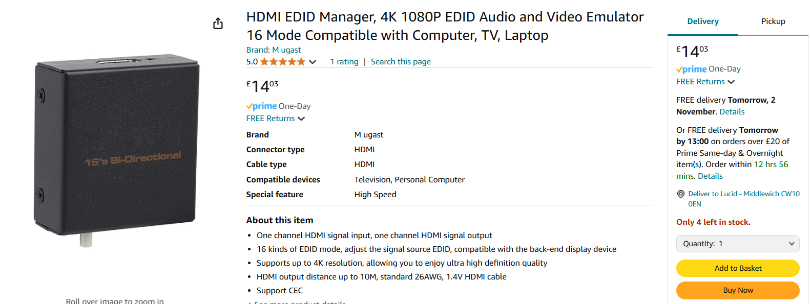

It's a HDMI HDCP conflict between the HDMI input on the TV and the HDMI output on the Sky box. The socket remains live even if the TV is off. Part of the HDMI cable includes a 5V feed which draws power from the Sky box. HDMI can be finicky, and if all the devices aren't up to their latest firmware updates then issues like this can occur. You have a couple of sensibly priced options. One is to replace the Sky 1080p HD box with a later model, possibly one with a network connection so it can get firmware updates. You'll still be able to pick these up as used buys.
The other thing is a little device that spoofs the TV into believing it has a more up-to-date HDMI source connected. This would be a HDMI EDID manager.

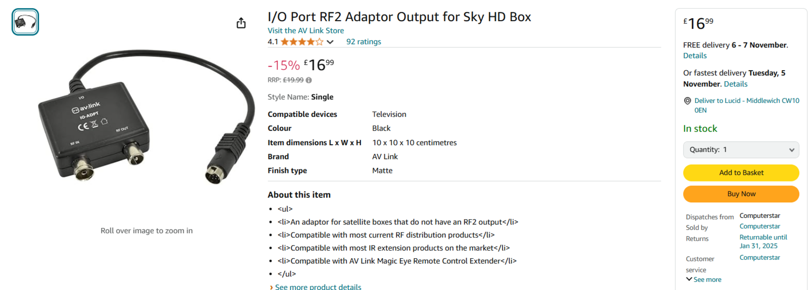

If you go for a later Sky box, you will probably find that there's no RF2 out. You'll need a dongle type box for that.
