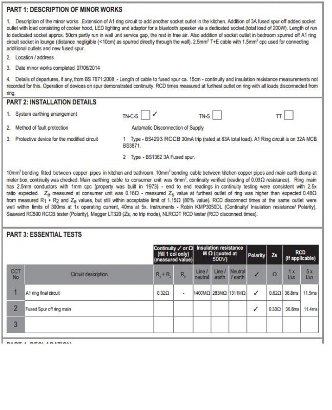

Certificate:
Part 2
3. Protective devices
1. Type - The MCB protecting the ring, BSxxxx 30/32A?
2. Type - The fuse in the FCU, BS1362 3A?
There is no need for any of your text but -
"Looks like 6mm²" isn't really good enough,
Re: measured Zs - Megger no-trip readings are notoriously unreliable - get a Fluke. Use the added figures of Ze and R1+R2.
As above - 1x limit 300 ms.
Part 3
It's not a Ring main (they are in the road); it's an A1 Ring Final Circuit.
You have not recorded R2 nor IR for the spur.
The Zs of the spur is half that of the ring ???
Thanks for the replies. I took the previous version of the minor works down as I realised a few things were wrong. The hawk eyed among you obviously spotted it too quickly! I wonder if anyone can please identify the size of the green/yellow bonding cable (pics show this at the meter box and the other end attached to pipework under the sink) and the smaller green earthing cable in the meter box? I'm assuming the green/yellow sticker on the neutral lead means it's been used a return earth? The slimmer green earthing cable goes straight through my meter box and terminates in my upstairs neighbours meter box earthing terminal. I took a reading of the resistance between the consumer unit end and the end at this meter box and it was 0.18 Ohms - does this sound acceptable? The resistance for the larger bonding cable to the kitchen came out 1.48 Ohms (probably in the regions of 10-15m of cable).
Regarding the Zs value, I took this at the furthest outlet on the ring circuit. I actually went round and measured it at every outlet - that for the new double socket the fused spur is taken off (which is very close to the consumer unit just the other side of the kitchen wall) came in as 0.27 Ohms. The Zs values increased the further I got from the consumer unit in quite a consistent fashion to give the maximum 0.62 Ohms at the furthest outlet. Not a lot I can do about remeasuring RCD times as the kits gone back, I think I thought measure at the furthest outlet on the ring because that's the furthest distance the current has to travel to trip the RCD. Still, I measured the times at all the outlets on the ring and they were all well within limits (and very similar values), so I'm happy that it's working as it should. One thing I did find - the lights and immersion are only on an MCB, not an RCD and MCB. I suspect if I got a PIR done professionally they'd say do something about that.
Bonding conductors should measure out at 0.05 Ohms or less.
That is wrong - it's far too high. Assuming it's 10mm wire, actual resistance should be around 0.02 ohms
Even if it was tiny 1mm wire, your value is still massively more than it should be.
On a ring circuit, the Zs value should be the same at every outlet.
Increasing as you get further away from the origin indicates it is a radial, or a ring which has been broken somewhere. If the protective device for the circuit was selected as if it would be a ring, it will now be the wrong one.
As regards the ring final, what were the end to end results?

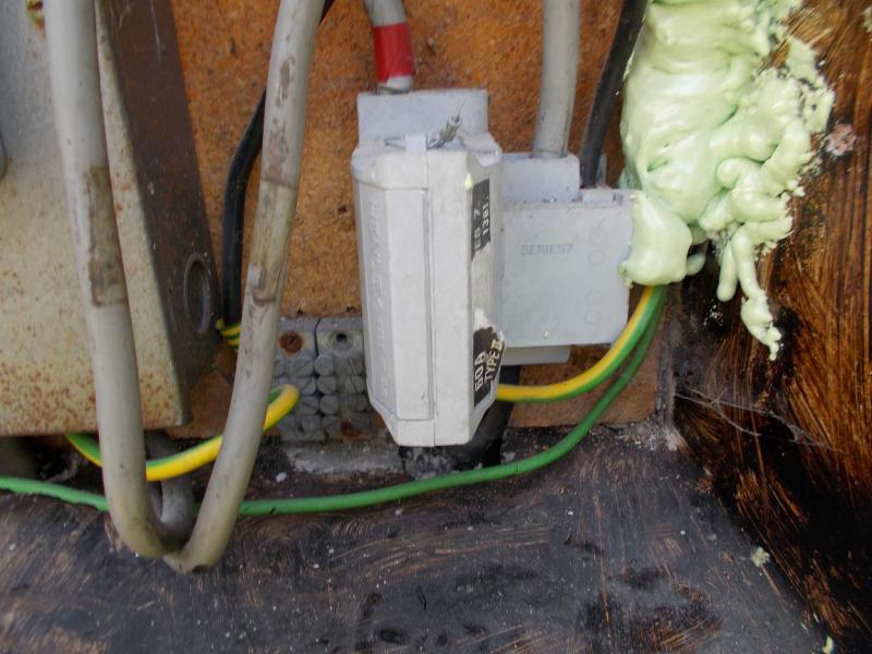

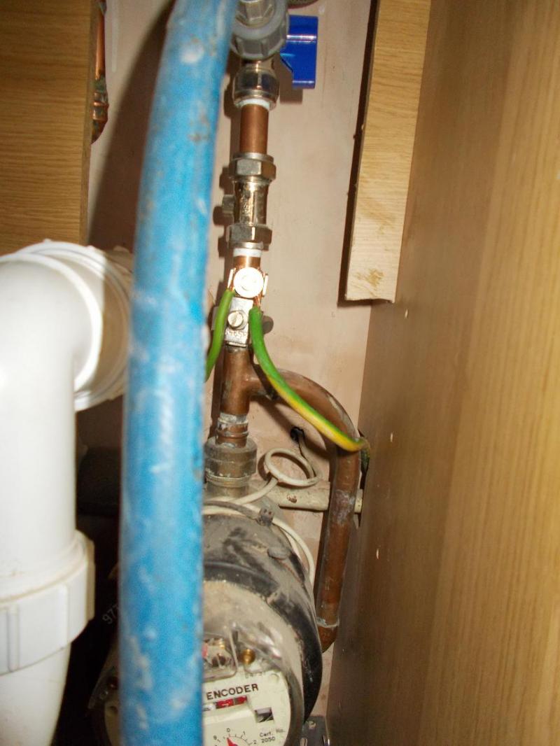

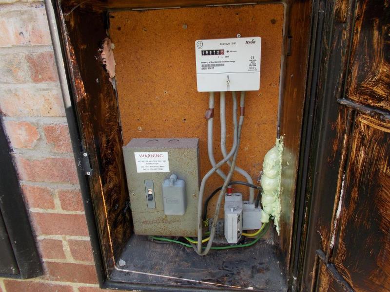

I can't really tell.
If you can bend it with the fingers of one hand then it is likely to be 6.
Can you tell using this? //www.diynot.com/wiki/Electrics:flatpvccables
Just because it is black does not mean you can call it a neutral lead.
It does appear to be an earthing conductor.
Please confirm that it is connected to the cut-out as there is a black cable below and behind which looks like a continuation.
If that one is 6mm² then the others must be 10mm².
No, they should be negligible, <0.05&#937;.
Did you deduct the resistance of your leads?
You could recheck this with a multimeter.

The black lead with yellow/green tape on is just connected to the earthing terminal. The other bit of yellow/green cable below the tape in the picture goes from this terminal to somewhere inside the metal box on the left (it goes in underneath). Thanks for the link on cable sizes - I've measured the bundle of strands and I'm now pretty sure they're 6mm earthing and 10mm bonding (I tried the bend it with your fingers thing too, good tip!)

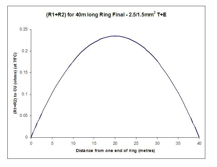

That couldn't possibly be true. One socket could be right next to the CU, with an (R1+R2) of virtually zero, whilst another might be in the middle of a 100m long ring, hence with an (R1+R2) corresponding to two 50m long cables in parallel (i.e. fairly 'high'). Zs is obviously just (R1+R2) plus Ze.
With a ring, (R1+R2) increases (along both 'arms') non-linearly from zero at the CU to a maximum at the middle of the ring (see illustrative graph below). With an unbranching radial, (R1+R2) will increase linearly from CU to the far end. Again, Zs is obviously just (R1+R2) plus Ze.

sounds like my Zs values were behaving as expected.....great :LOL:
