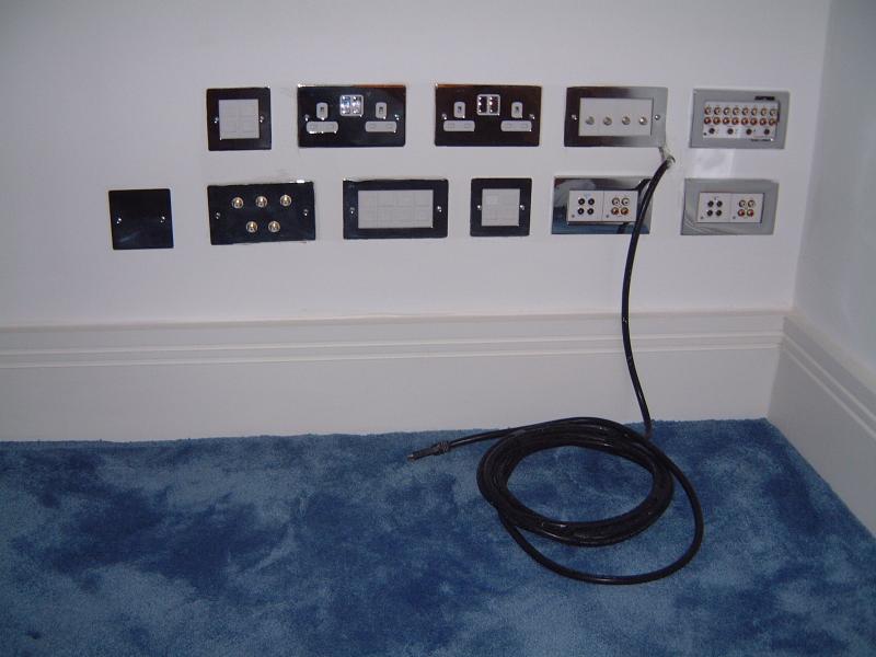

Hi,
I have taken a spur off to a fused switch behine the tv unit. I have gone from there up to behind the tv which is wall mounted.
I have like an idiot, forgotten about the dvd, amp etc, that will sit on tio of the tv unit below.
Can I change the fused switch over to a double, IE fused, and then a socket next to it, I could do with a double faceplate with one side fused and the other a socket, but cant find them...
Bob
Basically nobody makes an accessory like that.
There are some grid systems which would let you put that combo together, but the socket would be unswitched, and whether it would match the existing ones you have...
This is what you want behind the TV etc....
I dont see the point in a socket behind the TV if you have a DVD player etc below anyway - you may aswell run the TV mains lead with the scarts, HDMI etc.
