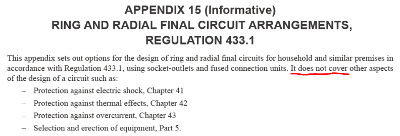

I thought Appendix 15 was merely 'informative'.
It is, so Harry's use of the word "allowed" was probably wrong. However, I do vague recall similar to him, that there was a time when the guidance (or maybe even a regulation back then?) 'accepted' two single sockets from an unfused spur
Didn't read every post but you could downrate the whole circuit to 20 amps...maybe.
Indeed. It says ...
... which, apart from seeming generally daft, does not really make much sense to me - what is "an item of stationary equipment connected directly in the circuit" if not, effectively, an 'unfused spur'??
