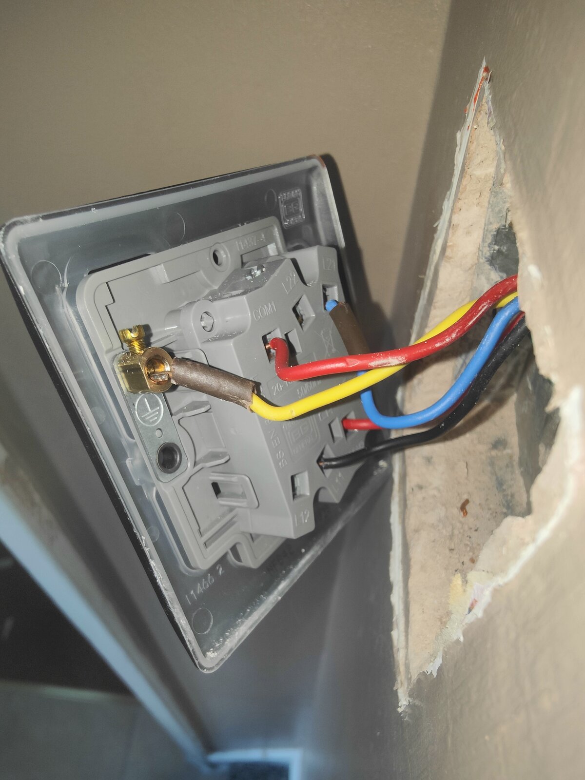

I just getting a bit confused related to this so I just decided to install our new double light switch what leads upstairs and down stairs

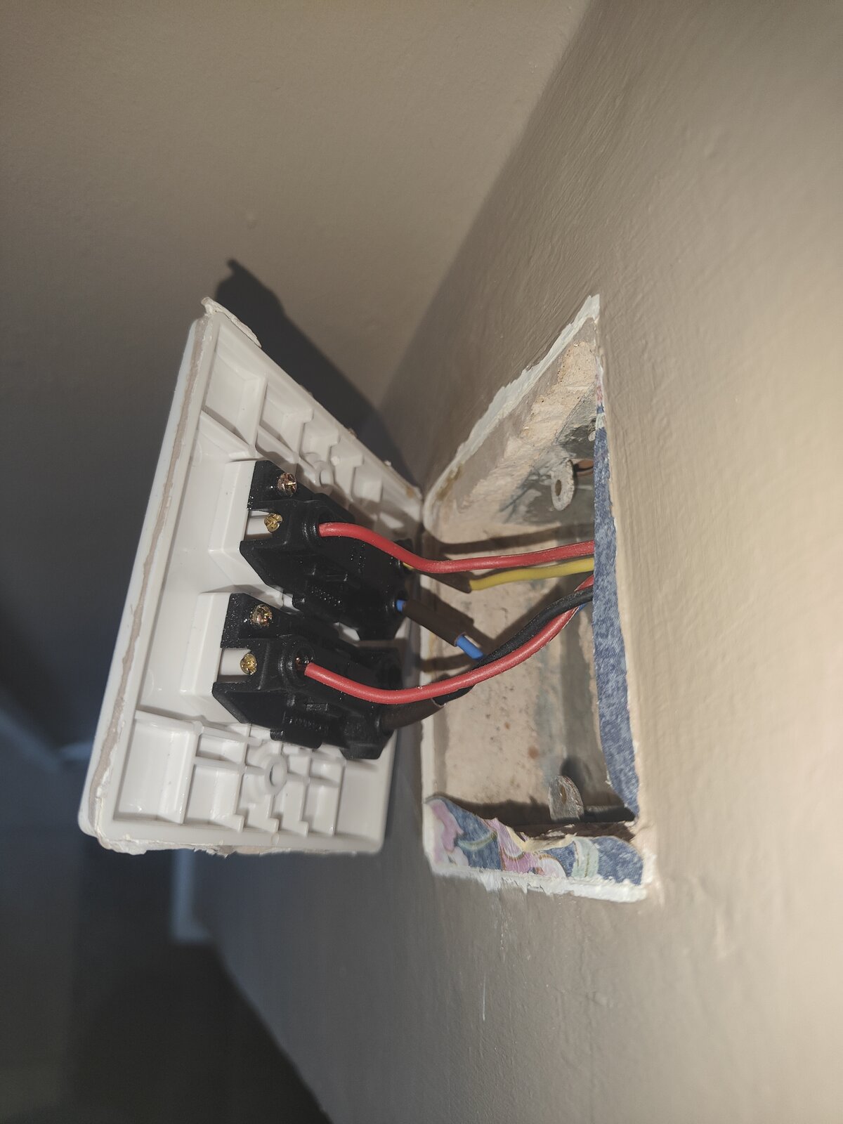

Which if you see attached file this is what it was originally (white light switch)
And I followed everything on that and done it to the new one but only one light is working.
I have attached the other light switch setup
New setup is upside down on the second side.
Both Reds are in Com 1 and Com 2
And
Black in L11
Blue in L21
Also is the earth wire in the correct position
Thank you

You seem to have put a live in the earth....but I suspect that the yellow should be in L22
I am not an electrician,
looks rather dangerous ATM.
The yellow wire with brown sleeve, should be in the terminal on the other side (in the hole next to the blue)
It is NOT an earth wire it is Yellow sleeved Brown to indicate it is a live conductor.
Just copy the old switches allowing for one switch being upside down.
How many lights do the switches serve and how many are one way and two way?
The yellow needs moved to L22 next to the blue. You are lucky you haven't had a shock off the faceplate.
BUT. You then must connect an earth to the faceplate. Your old plastic one didn't need one. Are there green/yellow wires in the back of the box?
Yes agreed
Yes you are very lucky, it could have been very nasty
Yes agreed
I don't see any hint of additional wiring (earth), if that is the case then the matal switch cannot be used for everyones saftey
Is there an earth wire? It may have been cut so check where the cable enters the backbox.
Cant see the cables entering, is it possible it is the earth wire?
