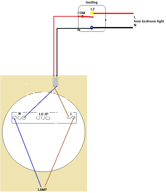

Now the next bit. our landing has a dogleg, there is a different light around the corner from this one which has its own switch you the bedroom door. We have decided we'd like it to come on at the same time but will need the switch by the bedroom door to wrok too. The light is easy I only have to put a new piece of cable to the other light.
As the moment there is a cable from the bedroom ceiling light to the switche and one from the landing light to the switch and the 2 black wires are joined together with a nut.

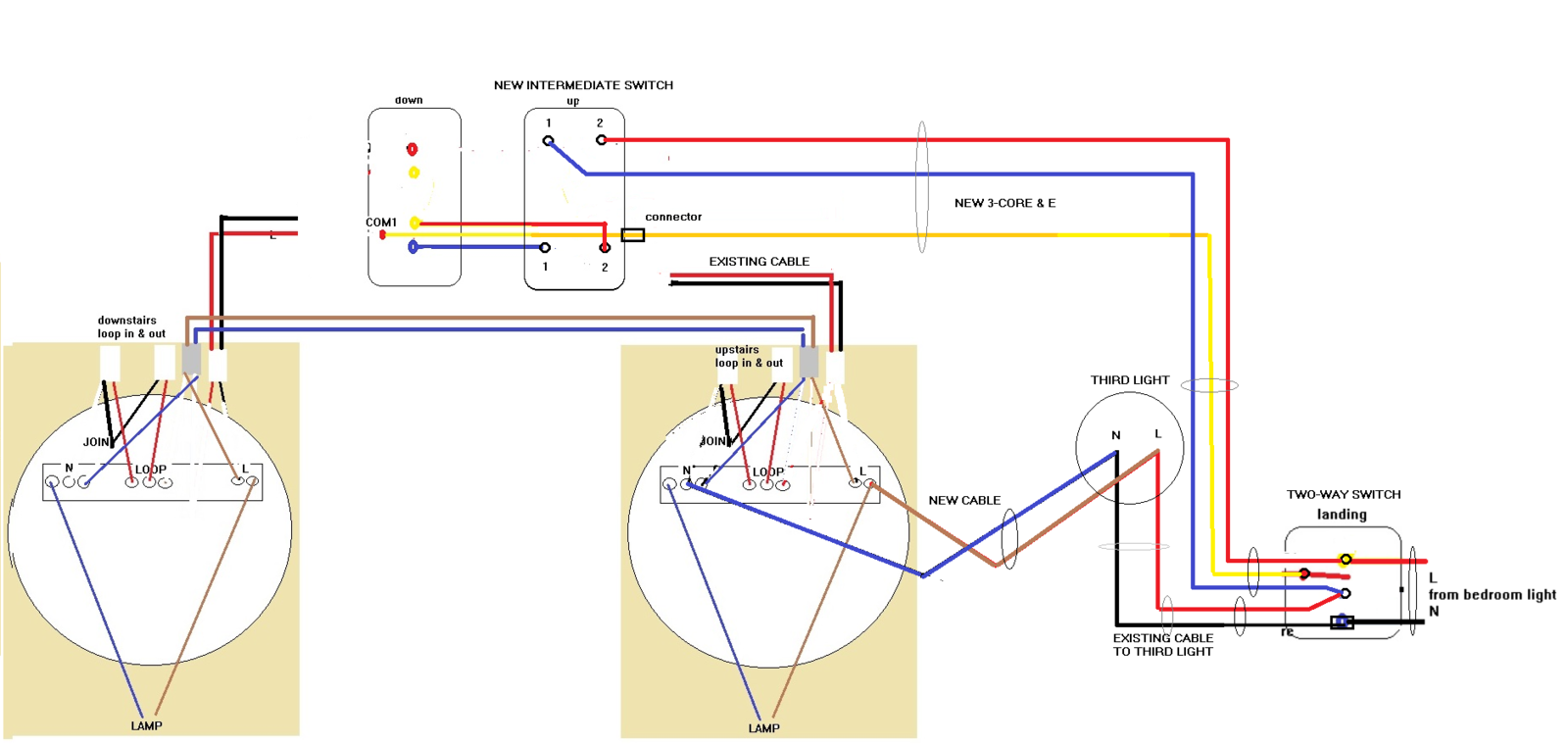

You will need what is called an "intermediate" switch and a new cable (possibly 5-core) between the switches upstairs.
This is the sort of arrangement, but, of course, connections can be moved around to achieve the same result.
Edit - corrected mistake.
Hi Jack.
I think this is how you're saying the additional light is connected
with a ceramic wire nut for the neutral loose in the switch.
Can you confirm this please?
Yes that is just what I have.
The join is an orange plastic truncatedcone shape screwed onto the black wires.
Elf I've studied your circuit.
I can possible get another cable in tHe stink pipe space to connect your brow into Loop in the rose and grey into L.
Disconnect the red and blue between the switches.
The unused 2 core can go to downstairs switch and be joined to a new cable to your black and blue.
There are other ways to do it. You could use the wires at the third switch to supply the circuit.
You would still need another cable from switch to switch and light to light but just normal twin and earth.
I'll amend the diagram after dinner.
Ignore switch terminal numbers for now.
I reckon convetional method as it only require 2 strappers.
