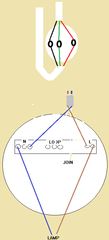

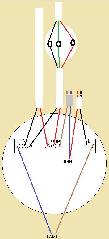

Is it right that the the only reason the 2 power cables are in the light is for the loop? They is a junction block in the attic near the upstairs light for one of those cables is it best to do it ther instead
It makes no difference electrically but I would advise not - so that it can all be restored easily in the future and be apparent.
Of course, you could leave the rose unaltered and use the connectors for the light connections.
If you currently have this:
and you can easily do this:
then yes that is a lot nicer, but don't go out of you way to do so.
Whatever happens make sure you keep all of the earthwires intact.

If you do this, don't cut anything shorter
I'd advise against this bit as the wires into the terminals forms part of the 'cordgrip' arrangement.

The more I think about this, the upstairs circuit wiring should be removed from the rose as not only is it on a different circuit, it is also on a different CU.
I don't know if that is a concern in a single property.
Perhaps a warning label or two would suffice.
All done.
The wires in the neutral were very short and one had broken at the screw so I have taken it into the junction box and made the red and black in the short piece spare to keep the earth going.
