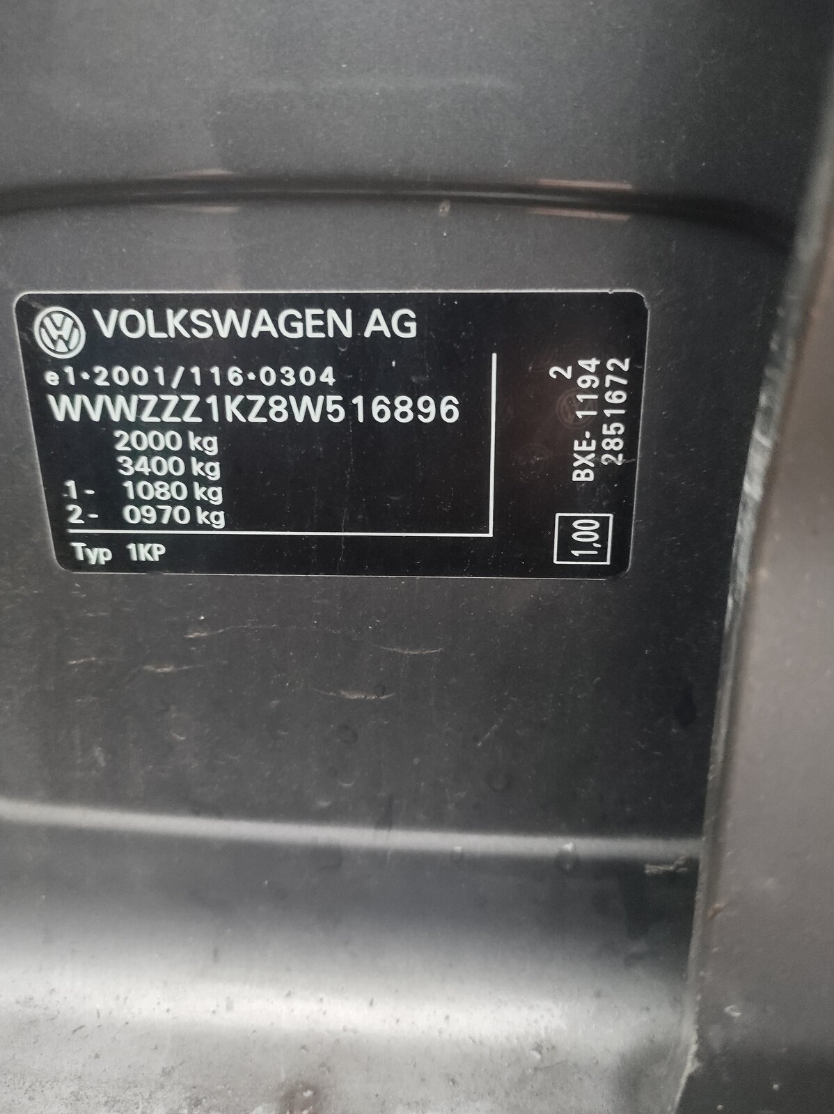

Some mention scratching something off a plate in this thread? What plate? What detail is being scratched off? What does it achieve? Just interested out of curiosity as never heard of this before.

There's usually a number in the corner of the compliance plate (or label) (sometimes with a "-1" superscript after it. That's the MOT smoke limit for the car. If that is illegible for any reason, DVSA's instruction to the tester, is to just test to the default smoke limit (which is nearly always less demanding). Really, they ought to just make an illegible plate a fail.

This is the sticker (bottom of passenger B pillar on VW). The limit is the number in the sideways box in the bottom right hand corner. I keep meaning to scratch it out but I've heard it's now on the MOT database - but clearly as per Trevor there's a way to override it even if it is.
