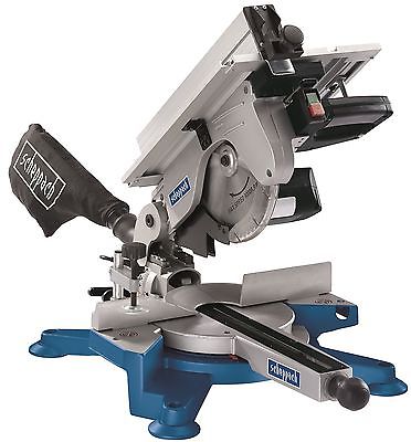

Not a flip over, I meant one of these.....
OK probably not brilliant but what do you want for £200, there's got to be a compromise otherwise you could end up spending 200 each for a semi decent mitre saw and table saw
We had a Bosch one on a job ten or so years back. Same problem with the blade always being a compromise, but useable as a rip saw, with caveats. OK as a chop saw, but limited visibility. Only real downsides were that if you set it up at the right height (on trestles) to work comfortably work a chop saw it was too high to use comfortably as a rip saw - conversely if you set it up at the right height to use comfortably as a rip saw then using it as a chop saw gave you a bad back. The saw table on these things are really small, so you need a second person to take off for you except on short pieces when ripping. Possibly OK for use on the floor, but in the environment I work on that would not be allowed on safety grounds

Planks can mean anything as vague as cutting cross grain. As for cutting deck boards to length with one, believe me when I say it's not fun having a table saw blade go through one of your digits.
Don't even chance it. For ripping down along the length, sure. I'd think twice on muddy ground in a crowded garden however.
I'd give serious consideration to a decent circular saw.
I have an Elecktra Beckum table saw with outfeed table, side extensions and slide. I use a circlar saw to rip deck boards. It's way faster and less hassle.
