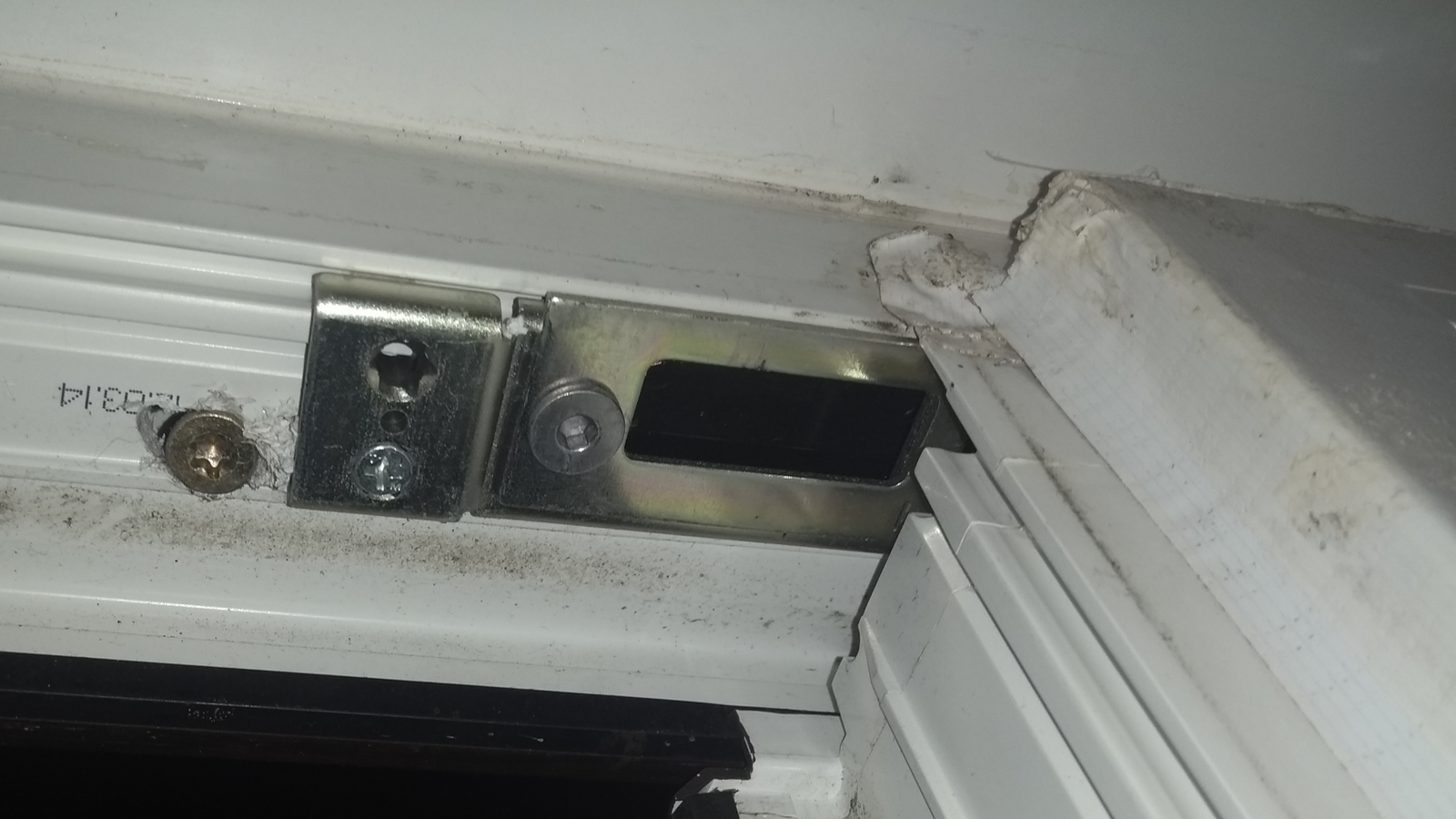

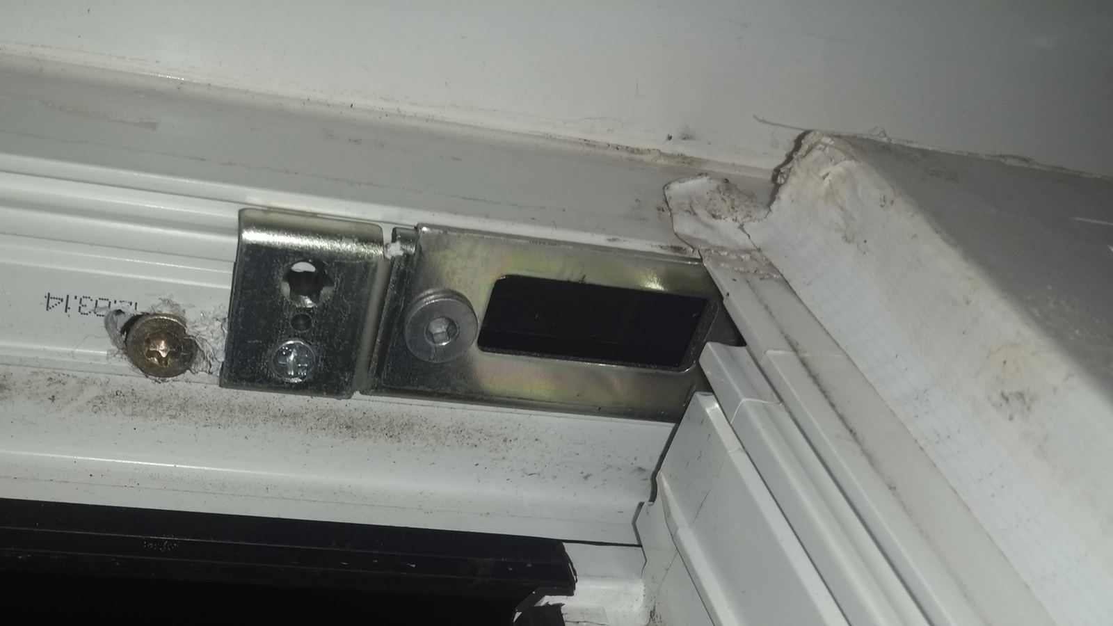

Top strike plate

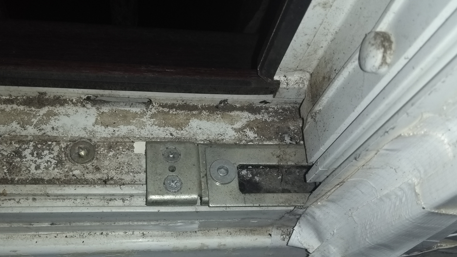

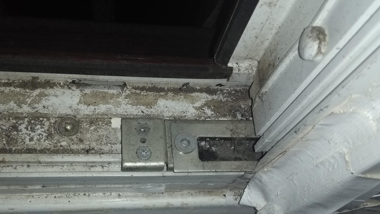

Bottom strike plate or whatever they're called, the bolts of the door insert into them when door locked

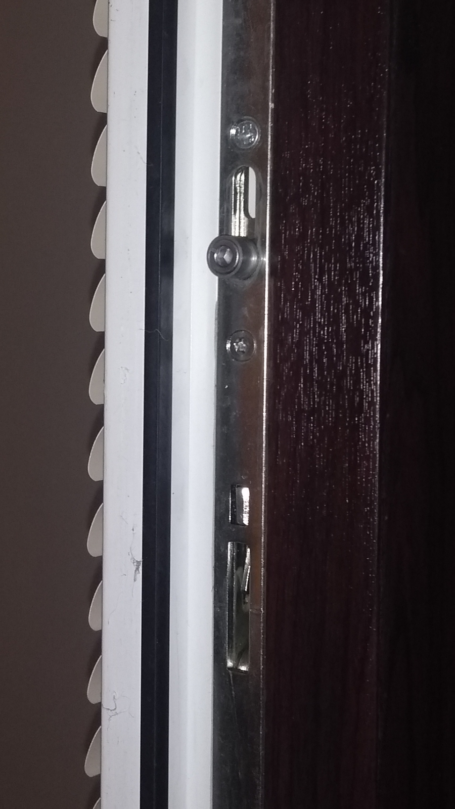

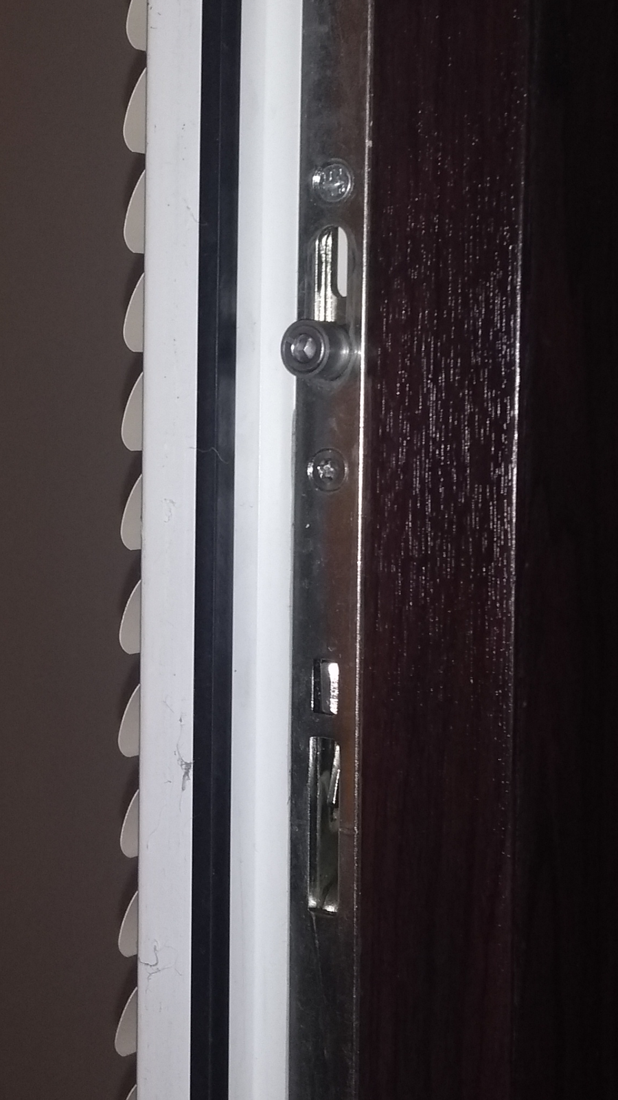

Locking mechanism

In your top and bottom ones you can see the Allen key bolt, by turning that it will move the ' keep ' either in or out,so that when you pull the handle up the top and bottom of the door lock will locate in them, in theory adjusting the top and bottom compression. Your other picture shows the cAm , which again has an Allen bolt which can be turned, by turning it you can alter the compression where the cam locks onto the slave door. It'll probably only take small adjustments, but if no adjustments on hinges it's your only option.
If you're stuck with having to polish a turd consider changing the bubble gaskets for bigger ones or fitting self adhesive EPDM foam gasket to the face opposite the gasket. Shouldn't have to put up with that though. Are you dealing with the manufacturing direct or are you having to go through the housing association?

Yeah, both stike plates have been adjusted numerous times by many a HA maintenance operative and myself and it appears to make little to no difference or causes additional issues.
When the top strike plate is moved ever so slightly out toward the outside to increase compression, the door handle becomes difficult to lift up to lock and although being on the 2nd floor, I still like to lock the doors.
When the handle has been forced up and the key turned to lock it, it's far more difficult to turn the key to unlock and feels like the key is on the verge of snapping, although it actually increases the compression down the centre of the doors, I can still slide a 2 pence coin through the top and bottom seals of the door and without resistance.
The locking cams have all been rotated towards the door and the cam recepticals on the slave door have the same allen key adjustments, and have all been adjusted moving them towards the outside.
