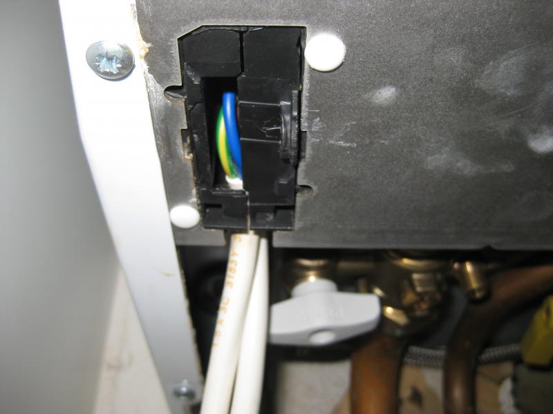

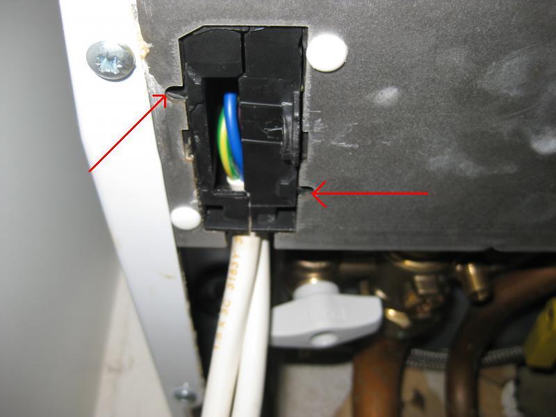

I'm having a bit of trouble removing the electrical cartridge from the boiler.
Is there a knack to getting these out??
Have you undone the two screw which secure the cartridge in place?
There is also a single screw holding the cover on the cartridge.
There are 2 white plastic "pins" on the underside of the boiler, on either side of the electrical cartridges hole, no screws though.
I did have the boiler cover off and pulled out these 2 pins which released the block that I believe holds the cartridge inside but I couldn't open this any further.
I was under the impression that it should be possible to just pull the cartridge out from the bottom of the boiler without taking the cover off?
They are holes, not screws.
Then the screws are missing!
Can you remove the cover from the plug? That would allow you to see how the two cables are wired to the plug, which would be good enough to determine what is wrong.
Managed to get the cartridge out finally
SCR:
Boiler electrical cartridge (The top cable is coming from the mains, the bottom cable is the one connected to the SCR):
Doesn't look right to me but I'm no expert by any stretch!
The wiring is correct.
The brown and blue wires provide power to the SCR from the N and L terminals of the boiler. The link between L and 1 is required so the SCR can feed 240Vac back to boiler terminal R via terminal 3, which is the switched live.
Sounds like a fault in the SCR. The switch which connects 1 to 3 when the SCR is turned on is obviously closing at random times. If you have a multimeter you can check the SCR.
