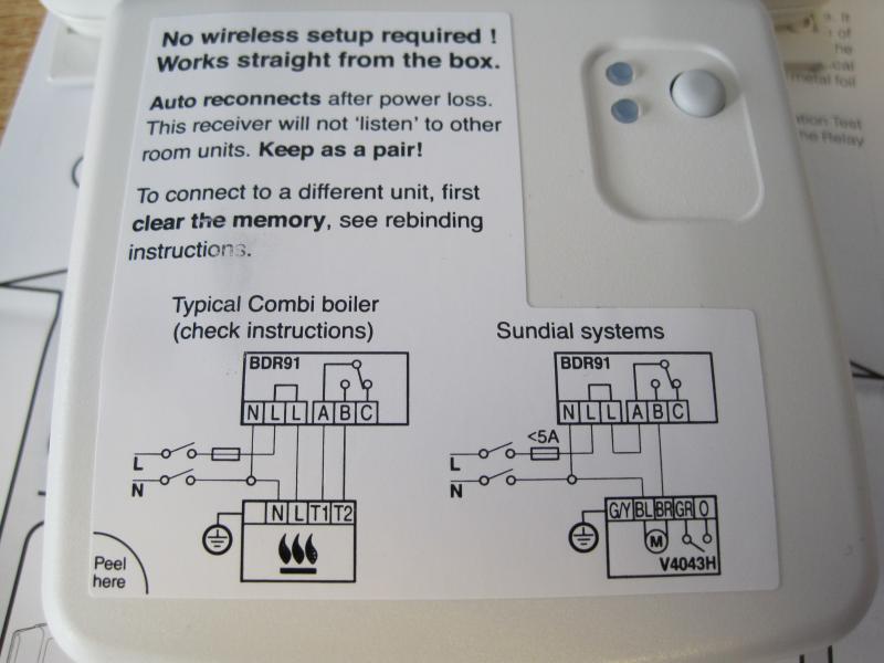

OK, I took your advice and bought a CMT927 but the wiring diagram that it came with is a bit confusing, (no surprises there!)
The diagram for connecting to a combi boiler appears to show that the live wire from the mains should first go to the Honeywell receiver and then a second wire from the receivers second live terminal goes down into the boilers live terminal. The neutral wire from the mains however looks like it should go to the boilers neutral terminal first and then onto the receiver:
It also says that the receivers A and B terminals should be connected to the boilers T1 and T2 terminals but my boiler does not have these terminals. Here is a picture of the terminals inside my boilers electrical cartridge (pic shows it still currently wired into the existing Drayton SCR, the 3 core wire on the top left is from the mains and the 3 core under it is going into the Drayton SCR):
Would you be able to advise how I should connect this new Honeywell to the boiler please?

Ok, I decided to just go for it.
I've left the L and N from the mains connected directly to the boiler and have connected the L from the boiler to the middle L on Honeywell receiver and the N from the boiler to the N on the receiver. I've then linked the right L terminal in the receiver to the A terminal in the receiver and connected the B terminal in the receiver to the R terminal in the boiler.
It all seems to be working ok but does this sound right? I can post a pic if needed.

That's correct.
Nice one, thanks very much for your help with this.
