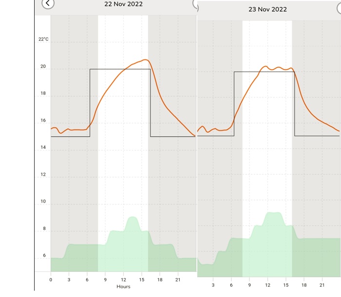

This what I am getting in my Mrs Office. Quite a big upstairs room. 5M x 3M approx.
She starts at 9am and finishes at 5pm
correct. Looking at those charts you have 20C set at 8am but its not getting there until 10:30 (ish). If comfort was enabled the heating would probably fire up at around 5am asis. It seems it takes 3 hours to go from 15.5C to 20C. Hence you could change it to 20C at 9am (with Comfort) and the heating would start around 6am. It must be rather chilly in the room when Mrs starts work. Note comfort is a system wide option and other settings might need changing. I assume you have other rooms working to separate schedules, they would also need to be corrected to once/if comfort was enabled.
Is the insulation poor in that room, it does seem to drop rather rapidly. My lounge only decreased 2.3C between 23:00 and 5:30am (23rd to 24th Nov) until the heating kicked in.

It was more an observation that the room is decreasing at a faster rate than I would expect. If the room is unused, there is little point keeping it heated evenings/overnight.
Comfort mode would allow the system to target your desired temp for 9am. At the moment you are providing 1 hour of preheat which does look a bit optimistic and will only worsen going into the winter proper. That said, it's a balance between room temp, cost and perhaps happier Mrs. The advantage of comfort mode is that it takes some of the guess work out of how long it takes to get up to temperature.
