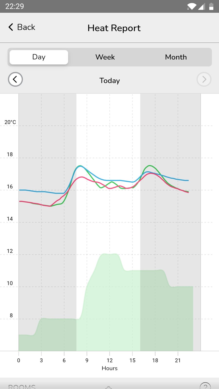

Just for the sake of comparison, here's some screenshots from my system in operation today.
I am running with Opentherm, Comfort Mode and Eco Mode, with Wiser TRVs on all rads.

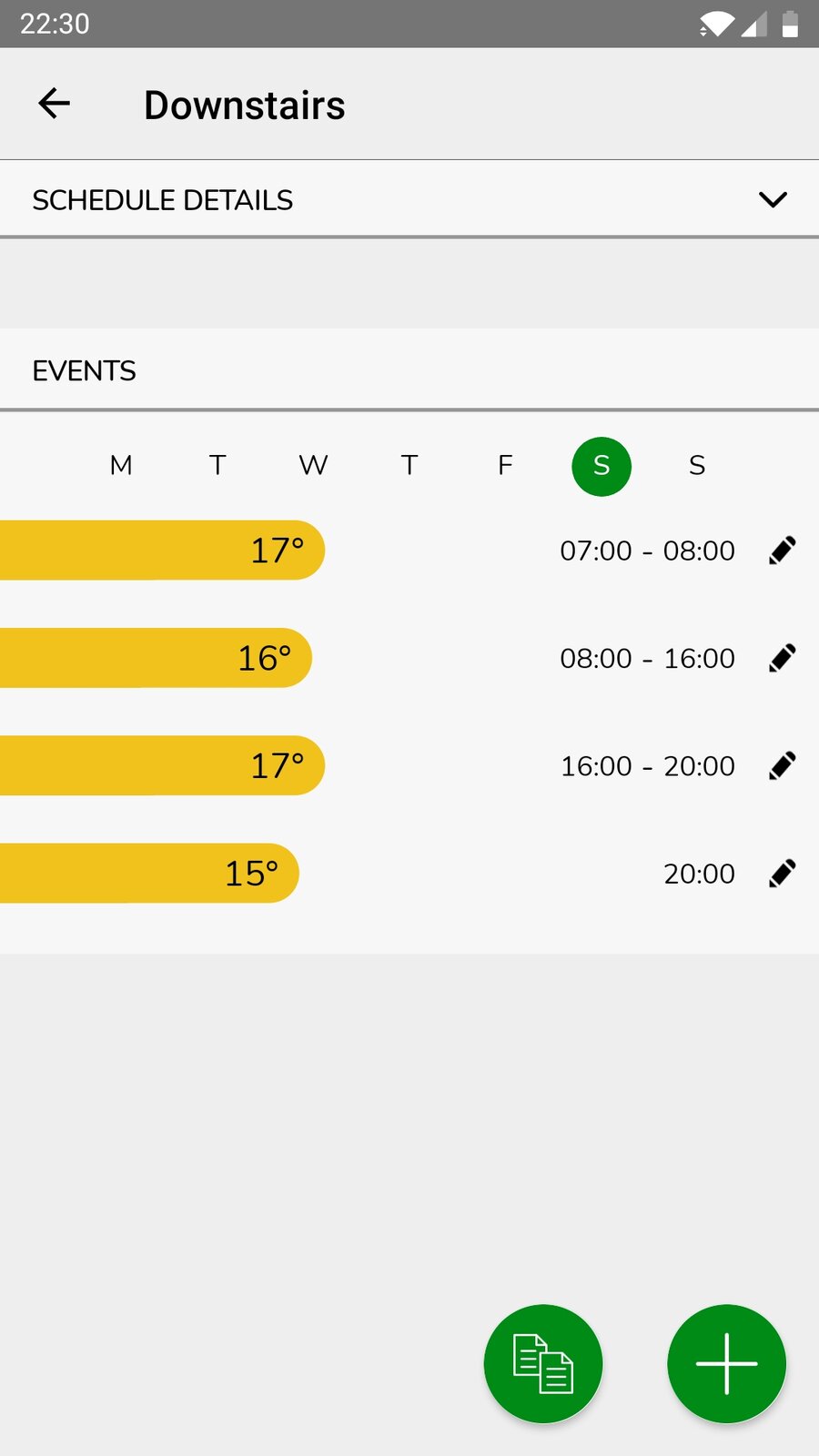

These pics are from the "Downstairs" zone (three rooms) which I have chosen to run on the same schedule and a bit colder since I'm mostly using upstairs. These are all TRV measurements so some of the overshoot you see is probably not real - the room stat is more accurate and I use that in my study.
Rooms:
- front room (blue); double-panel rad, adjacent to next door
- hall (green); double-panel rad
- kitchen (magenta); single-panel rad
A few points of interest:
- You can see Wiser adjusting the set point time individually for each room in an attempt to try to hit the desired temp at the right time (look at the black line relative to the shaded areas)
- It's not fully able to compensate for the slower-heating kitchen (likely due to the rad) but makes a good effort overall
- It does not let the temperature sag below the set point
- You can see Eco mode being quite aggressive and effective - e.g. the Hall heating is turned down at about 17:00 at 17.5 deg and allowed to decay way before 20:00 called for in the schedule
I expect the effect of Comfort and Eco mode probably varies a bit depending on your property's insulation and heating effectiveness. I only have 6 rads for a 3 bed house and I run them at around 55 deg so it heats quite slowly, but I also just laid out for new roof insulation which is probably helping slow the heat decay so I have no issues with Eco mode.

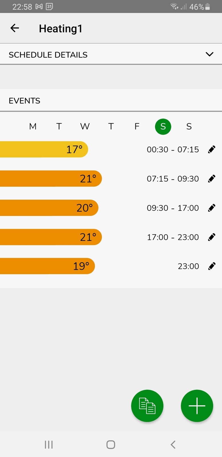

I have both Comfort & eco enabled. my schedule is
21C 07:15 to 09:30
20C 09:30 to 17:00
21C 17:00 to 23:00
19C 23:00 to 01:00
17C 00:30 to 07:15
Basis is occuppied house during the day.
What actually occurs setpoint wise is
05:30 21C (comfort until 07:15)
09:00 20C (eco until 09:30)
16:30 21C (comfort until 5pm)
21:00 19C (eco)
23:30 17C (eco).
In general, my lounge is close to 21C at 07:15 and 17:00 as scheduled.
Of course, although eco has brought forward the setpoint reduction to 19C at 21:00, the actual temp was 21.1C. Likewise at 11pm it was still 19.9C. Even with the nominal 17C overnight the lounge temp only dropped to 18.6C prior to the heating starting at 05:30. I have a 2 channel wiser hub (hot water + 1 heating channel) with no smart TRV's. Most of the rooms have old style TRV's. Hence just a single room within the wiser system being managed.

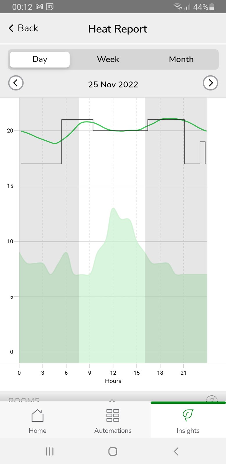

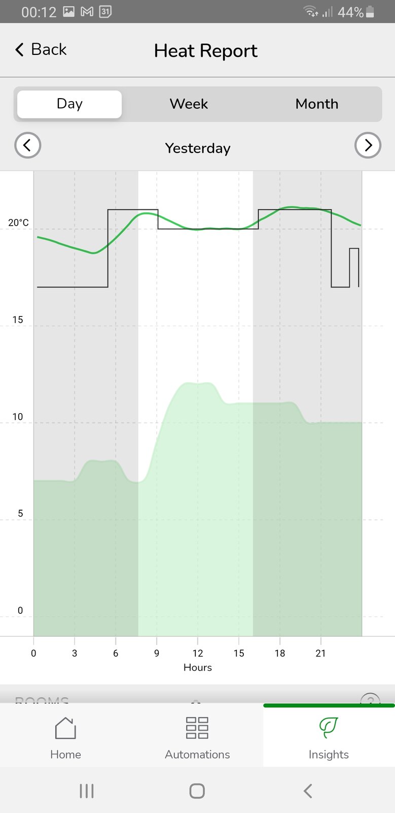

This is how my system has performed over the past couple of days.
