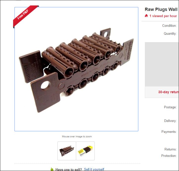

I've accumulated over years a box full of assorted drill bits, a box full of assorted rawlplugs and a box full of assorted screws. As far as I can make out, none have any kind of number on them to say which goes with which.
Whenever I want to hang something on a wall I always make a right mess of it because the three items don't match up and I have to do a fair bit of trial and error and it usually ends up with a bodge. I've muddled through like this for years.
If one buys all these things new, in sets, are they all number-coded or whatever so that one knows which goes with which? Or is there some way you can teach me to get my assortments to match up with one another?
Not really. Foxhole: it says the size of the yellow red and brown, but then says they can be any colour, and does not tell you the size number of the corresponding drill bit. :(
when you buy plasplugs, get them in a block. There will be a rectangular piece of plastic moulded in the middle. It has holes, as examples of the correct sizes of drill and screw moulded into it, and the dimensions stamped on. Keep this rectangle with (at least) one of the plugs still attached for future reference.
see?
Apart from special jobs, I only use brown plasplugs in walls now, it's simpler, and I keep a masonry bit of the correct size with them. If your walls are very crumbly you might need a slightly smaller drill.

JohnD .. I never buy plugs (because I have accumulated hundreds over the years and they have all ended up in two old ice cream tubs).
But if buying the ones you suggest would solve this problem of matching up the sizes, I would be prepared to buy a pack and give my lot to the charity shop!
I looked on ebay and there was a pic! I've never seen this size hole before because I've been using my own loose plugs out of the ice cream tub for decades. They either never came on a strip or were long ago detached from it!

Consider buying a few boxes of Fischer SX plug range......SX 6, SX 8 and so on - and chucking all the rest in the bin. With a corresponding drill bit, all you'll ever need.
