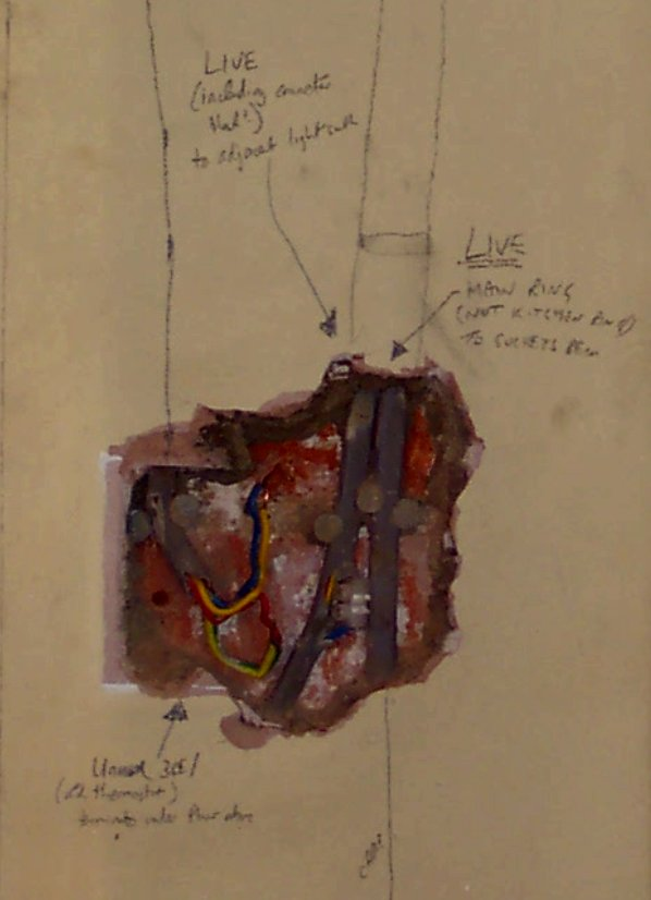

I can't really compete with that, but I found this in the wall of my daughter's cottage (completely buried in plaster, with nothing on surface to indicate its presence!). I don't know about yours but, as you can see by my scribblings on wall, most of what I found (including a totally unprotected chock block) was live (apologies for poor quality pic!) (IIRC, neither the switch nor socket mentioned in my wall scribblings were even vaguely aligned with the cables, so they probably were not in what we would call 'safe zones')...
Kind Regards, John
