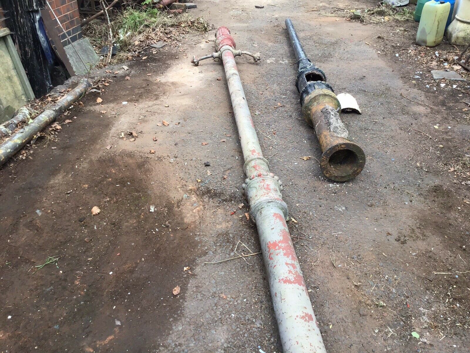

The SWA terminates at a outdoor socket then from that goes to a weatherproof FCU then comes out in rubber flex (in conduit) as its a cast iron lamp post that was originally gas powered so there were no provisions for electrical cables
This would be my main point of concern... IF the lamp post does have the iron tail buried in the ground, and therefore a reasonably low impedance earth path, then the 0.75-1.5mm? flex conductor from the outdoor socket to the lamp is woefully inadequate as a bonding conductor, and could easily melt as Ericmark described in his post about the radio amateur. If the post is in contact with true earth, then surely it should be bonded to the installation earth with something rather more substantial, like 10mm? This might be achievable using the cable armour, depending on its copper equivalent size.
Or, it may be possible to avoid the whole issue of exporting the earth from the house by replacing the lampholder with a plastic one and the flex with 2 core if the insulation requirements can be met. Or install a SELV LED light source in the lamp post with the transformer remote from it.
"no provisions for electrical cables"
A cast iron lamp post designed for gas, has an entry point at the bottom for the gas pipe, and passage all the way to the top, so there is no difficulty in running cables

Or treat the lamp post to a TT supply. with an RCD in the house
there is not straight answer here lol, the base of the post is sat direct in soil (no concrete) the flex supplying it has a 3a fuse via a spur and the whole thing has a 30ma rcbo in the house.
Does it need a rod? if so what size earth to the post and do I need to remove the earth that goes to it from the house?
I would have thought that the post was already acting as its own earth rod if it was in the ground and not in concrete?
Hi
We have an old converted cast iron lamp post in our garden that has a copper head on and a 230v bulb... this is all connected via an SWA cable from the house protected by a 30ma RCBO.
Is this OK to be connected to the house earth supply (PME) or should it have a Earth rod ?
