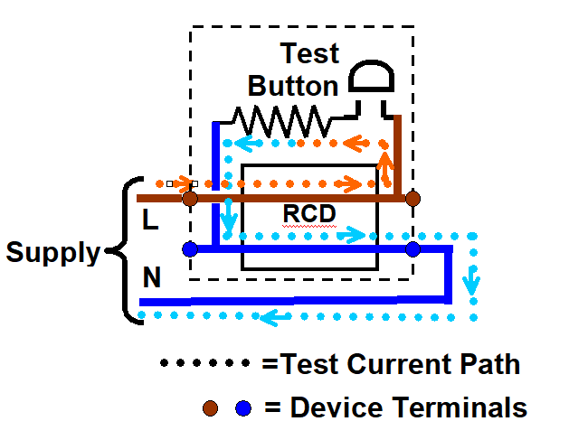

One more try ... do I take it that, for whatever reason, you do not believe (and/or understand) the explanation I've given about the unimportance of the direction of current flow through the two sides of a residual current device - an understanding of which seems to indicate that what the people at FuseBox wrote to you is simply not correct?
If so, consider the below diagram of a ('bench') setup in which the supply line is connected to one end (the 'supply' end in my diagram) and the supply neutral is connected to the other end (the 'load' end in my diagram). I have attempted to show the path, hence direction, of the test current flow with arrows.
With that arrangement, when one presses the test button, the entire test current travels through both the L and N sides of the device, so that the current in the N side is therefore identical to that in the N side - but the current is travelling in the same direction through both sides of the device..
Do you believe that, despite what I have explained, the device will not trip when one presses the test button, because those two identical currents flowing through the RCD will 'cancel'?
That illustrates my very point - that such would surely make absolutely no sense, given that there is an intentional connection between neutral and earth at the origin of a TN-C-S installation ?
They therefore presumably must mean an N-E fault on the circuit downstream of the device. However, whilst that might result in an RCD tripping (if there were other loads on the CU), I can't see how it could stop the device failing to response to pressing the test button, can you?

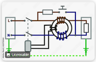

Just a picture from the internet.
Have Fusebox built their RCDs the wrong way round?

This would cause the problem.
Indeed it would. I think you've probably 'cracked it'. Well done and thanks!

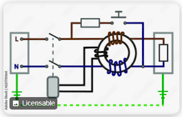

Having just looked, there are indeed diagrams of both methods of wring the test button out there.However, I've only ever previously noticed those which introduce the 'test resistor' between outgoing L and incoming N - and that'show it's always been with every RCD/RCBO I've taken apart. However, the existence of the diagrams like the one you posted presumably mean that some manufactures do it that way.
I think that everything I've written and suggested above remains true in terms of those devices that are wired 'the other way' (in comparison with your diagram ( i.e. like all those I've ever taken apart.) - but, as you imply, that ceases to be the case with the 'other method'.
I don't think there is realy a 'wrong and right', in the sense that, in the absence of any faults in the connected circuit, the test button will work as intended with either arrangement. I need to think further but, off the top of my head, the only difference I can think of is behaviour in the presence of an N-E fault in the connected circuit.
Are any made that way round?
Per what Bazza has now told us, it seems that FuseBox ones probably are. However, someone said earlier that a similar statement (about the effect of N-E faults) appears from some other manufacturers, so FuseBox are probably not alone.
I wonder if, rather than being 'wrong', FuseBox (and probably some others) are actually being 'clever'/thoughtful, in providing a test button which not only tests the device but which can also detect (quite possibly 'otherwis 'unknown') N-E faults in the connected circuit - thereby triggering the need to 'call an electrician' ?
