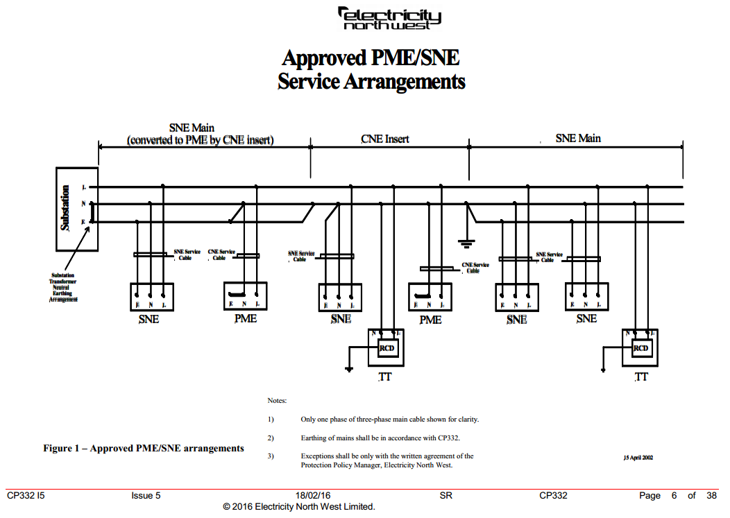

Thanks.
It's interesting to see that they have used only the terms "CNE", "SNE" and "PME", which makes sense, since those are characteristics of the network., rather than TN-S and TN-C-S, which also relate to how the supply is used (particularly in the case of the latter). As the installations on that diagram illustrate (and as I have been saying), whether or not a supply is TN-C-S depends upon how it is used. That's particularly true of the TT installation in the middle, since the supply to it is identical to the supply to the installation described as 'PME'.
