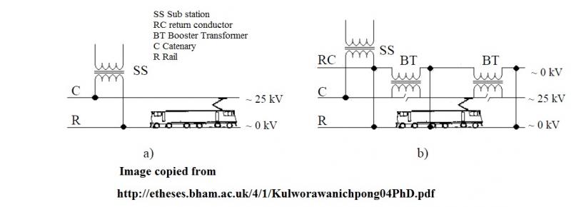

Electrical supply to trains does not rely on the ground for the return circuit,
A return conductor is used and the return current is forced to flow along this conductor by current transformers. These take the current in the over head catenary and use it to force an equal and opposite ( geographical direction ) current in the return conductor. This is normal strung as close as is safe to the over head catenary to reduce the amount of electro-magnetic radiation from the catenary,
( a student's thesis but the drawing is correct )
This system was not used on the first over head system and stray currents through the ground and the voltage gradients through the ground caused many problems for telecom systems, local electrical supplies and animals on the ground close to the tracks.
They still do!
