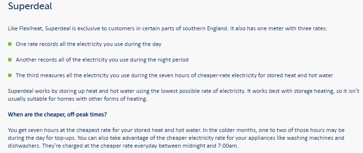

economy 7 water heater constantly heating water...
It says SSE Superdeal on the meter.
Note the bottom paragraph - so the heating/immersion may just have been on when tested.
What is that grey cable for in the meter photo? I'm almost certainly wrong, but it looks like the grey wire bypasses the meter and goes straight to the centre 100A switch marked 25A water heater!

Does look suspect. Looks more like it’s coming from the meter N-in terminal than the tamper proof DNO tails
Reading Efli post above it looks like a special 3 rate meter, I wonder if it had an extra output to run the water heater

It does look like it's coming from the N terminal, I hope that centre switch isn't switching it!
Reading Efli post above it looks like a special 3 rate meter ...
Indeed, and that's because up to two hours of cheap rate for "stored heat and water" can be during the daytime.,
I would say that it must have (for storage heaters as well as hot water) - otherwise it could not meter them separately (I reckon we're a few decades away from having 'smart devices' that can talk to a 'smart meter', so we're currently stuck with having to have one L coming from the meter for each subset of loads one wants to meter separately!).

The red cable marked O/P is i assume for the storage heaters, the red cable marked 4 for the normal supply and a 3rd grey cable just for the water heater, what i was getting at was maybe there was a 3rd 20 amp CU just for the off peak water heater and now its bunched in one of the 2 new boards
This meter only has 2 outputs though. With 3 rates, a high and low 24hr and a switched low for O/P.
You could be right! What are the odds that I checked it when that 2h was on!
Assuming that you knew it wasn't between midnight and 7am, the probability of that happening out to be 1 in 8.5 (2 hours out of 17) - or, if you are a betting person, 'odds' of 7.5 to 1 !

As Echo has said, it would seem that there are only two outputs - and, indeed, that's all that is need for the functionality that EFLI posted.
I presume that the black is a neutral (probably for everything other than storage+water heaters) which just goes 'straight through' that switch enclosure. We can only guess what the smaller grey one is, but I would think the most likely is probably that it is a second neutral (probably for the storage+water heaters) which, again, just goes 'straight through' the enclosure.

I looked up "code 52 (South) Superdeal Tariff" and it seems 10 hours split so I think this is what we call Economy 10 not 7? Not sure what times it switches on and off, but it could be doing what it should do?
Interesting, that's very different from what EFLI. That is very clear in talking about 7 hours off-peak rate - midnight-7am for everything other that storage+water heaters and, for the latter, 5-7 hours between midnight and 7am and up to 2 hours at other times.
