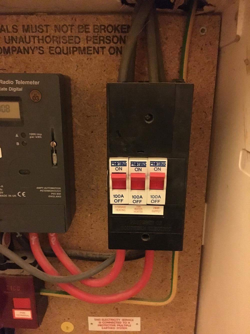

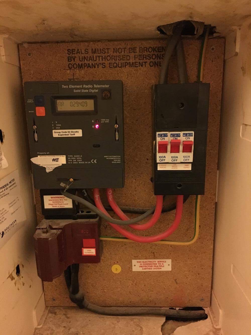

At 4pm there were no lights on the meter, at 5:30pm there was a red B light on. Cylinder came on on both those occasions. What does that mean?
I suggest you turn off the MCB marked water heater on your 24/7 board (the left hand CU), and then see what happens.

Well, there are two lights on the meter/switch, A and B. If it works when A is on and also when B is on then there's a problem. Those should indicate which tariff is in use.
I'm not so sure about that. If the tariff is per what EFLI posted, there are four possible situations ...
1... Day rate 'main' electricity, storage/water heaters off
2... Day rate 'main' electricity', storage/water heaters on (for up to two hours during day) at 'night rate'
3... Night rate 'main' electricity, storage/water heaters on for 5-7 hours during the off-peak period (also at 'night rate')
4... Night rate 'main' electricity, storage/water heaters off for up to 2 hours during the off-peak period
... but only two lights. I suspect that they don't bother to distinguish between 3 and 4 but, to represent the three situations (1, 2 & 3+4) with two lights, they presumably must use 'no lights on' (or, I suppose, 'both lights on' - but that could be confusing) for one of those three states - I imagine probably (1). If that is true then the water/storage heaters could be on when either of the other two lights (corresponding to 2 and 3) were lit.

you need to contact your electricity supplier and ask what the terms of your tariff are. It may not be the same as the sticker on your wall says. You may well have a couple of hours "top up" allowance and the (approximate) hours will be contractual. Your radio telewsitch picks up a signal from the Radio 4 Long Wave transmitter, but the exact times are deliberately randomised to prevent a big power surge from a million homes at the same time. The teleswitch will stop working when the Long Wave transmitter near Droitwich eventually breaks down and old spares are exhausted, as the plan is not to repair or replace it. Your teleswitch will then fall back to its own timeclock, which will slowly lose accuracy. Probably you will have been persuaded to use a "smart" meter by then.
