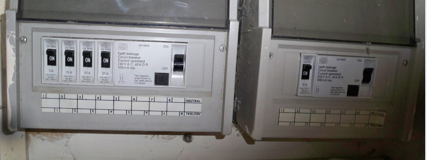

I wonder whether it is ever necessary (in a domestic situation) to have a 300 mA up-front RCD,
In most cases no, but it's certainly not impossible.
TT installation, submain to a distant consumer unit containing large numbers of individual circuits on RCBOs, and high leakage current on some of those circuits would be one example where it's necessary.
A 100mA RCD can only have 30mA of leakage current in normal use, once over that for even some of the time, it's a 300mA RCD.
The OPs installation claims to have a 300mA non-delayed RCD, which is exceptionally implausible.
I think that we are agreed about that. Again, it's not impossible, but I'm certainly rather doubtful.
