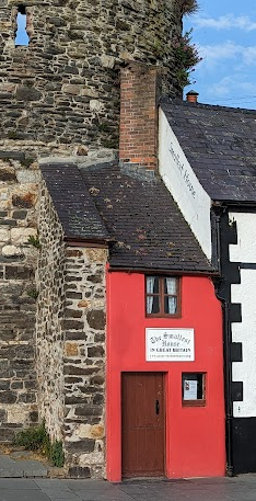

So I can see how there needs to be a minimum standard, however one has to ask the question, would living in this house 1716551807434.png be better than living on the street? the council declared the house unfit for human habitation, mainly down to its size, yet one can live in a tent or caravan which is much smaller than the smallest house.
In Wales we are seeing landlords saying enough is enough, and selling the properties and instead creating huge static caravan sites as up to date the rules with caravans are no where near as strict to those for bricks and mortar.
