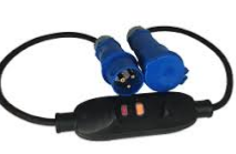

So tomorrow I go to work volunteering at local railway, and not a single RCD in sight, all extension leads, on a wet floor, the safety officer was an electrician until he resigned, easy enough to swap a MCB for a RCBO but not done. Not even a plug in unit, they are sold 1717541559256.pngthis one advertised at £48.23, any wonder why not used?
