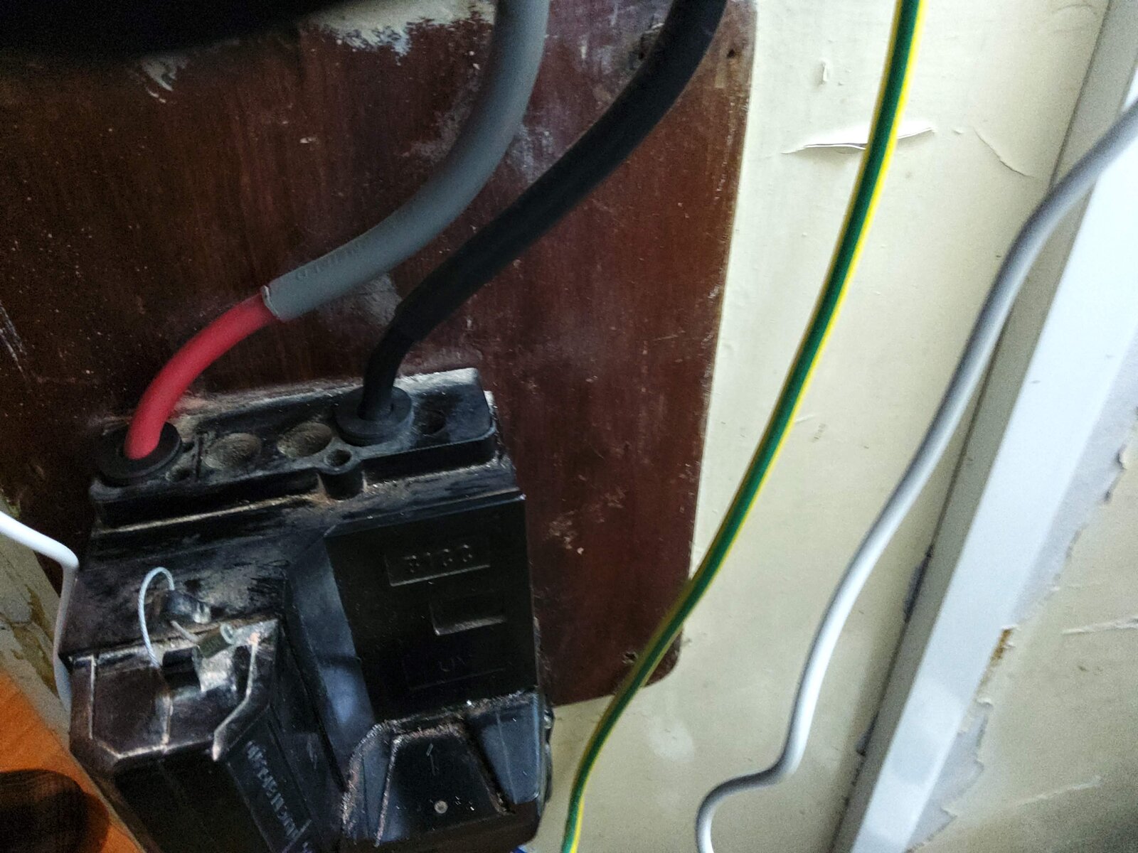

When I had a main fuse upgrade (60A to 100A) the blokes from UK Power noted that the existing tails were non-compliant as they had the outer insulation (black) removed by a couple of inches to show the colours of the cables inside. This was done by the previous DNO in the 1980s when the cutout was leaking bitumen and they replaced everything. Anyway, the new cutout required new tails so all good.

This was what mine looked like two years ago before they were changed. I suspect that the UK Power electricians were concerned about the amount of insulation that had been removed all those years ago. I wonder if they would have changed them if I hadn't ordered a more powerful cutout.

That's pretty 'extreme' - more so than anything I've personally seen before. It's usually just a few mm, as in the piccie I posted.
I'd say approaching an inch was more typical.
I've just had a look at mine, fully expecting to 20 patches of red and black but much to my surprise a lot less shows, like 1-2mm at the meter, at the henley only 4 of the 8 show and they are quite modest.
