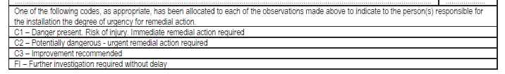

Given that there is a standard form for the report, might you perhaps write it in Section K, Observations ?
Eicrs would be done to the latest regs otherwise they wouldn't be much use. Classification codes are non compliance with the current regs that affect the safety of the installation.
Remember it's not a report on the person who did the work original, it's a report on the installation. It may seem perverse that an installation could receive classification codes on the day the installation is completed but better than ignoring things that are now known to pose a danger, for example wiring systems not correctly supported in escape routes (as an example, let's not digress into that!)
At the end of the report the installation will be deemed either satisfactory (only code 3s and observations) or unsatisfactory (subject to the agreed limitations), and any clarification codes listed, which would be at the discretion of the tester.
Yes, but Section K has a column for "Classification Code" and the notes at the bottom of it give no indication that it is acceptable to not give a code for each 'observation' - so which would he use - C1, C2, C3 or FI ? ....
That's a good idea, but it is section E as follows:
SECTION E. SUMMARY OF THE CONDITION OF THE INSTALLATION
General condition of the installation (in terms of electrical safety) .............................................................................................................................
Overall assessment of the installation in terms of its suitability for continued use
SATISFACTORY / UNSATISFACTORY* (Delete as appropriate)
*An unsatisfactory assessment indicates that dangerous (code C1) and/or potentially dangerous (code C2) conditions have been identified
