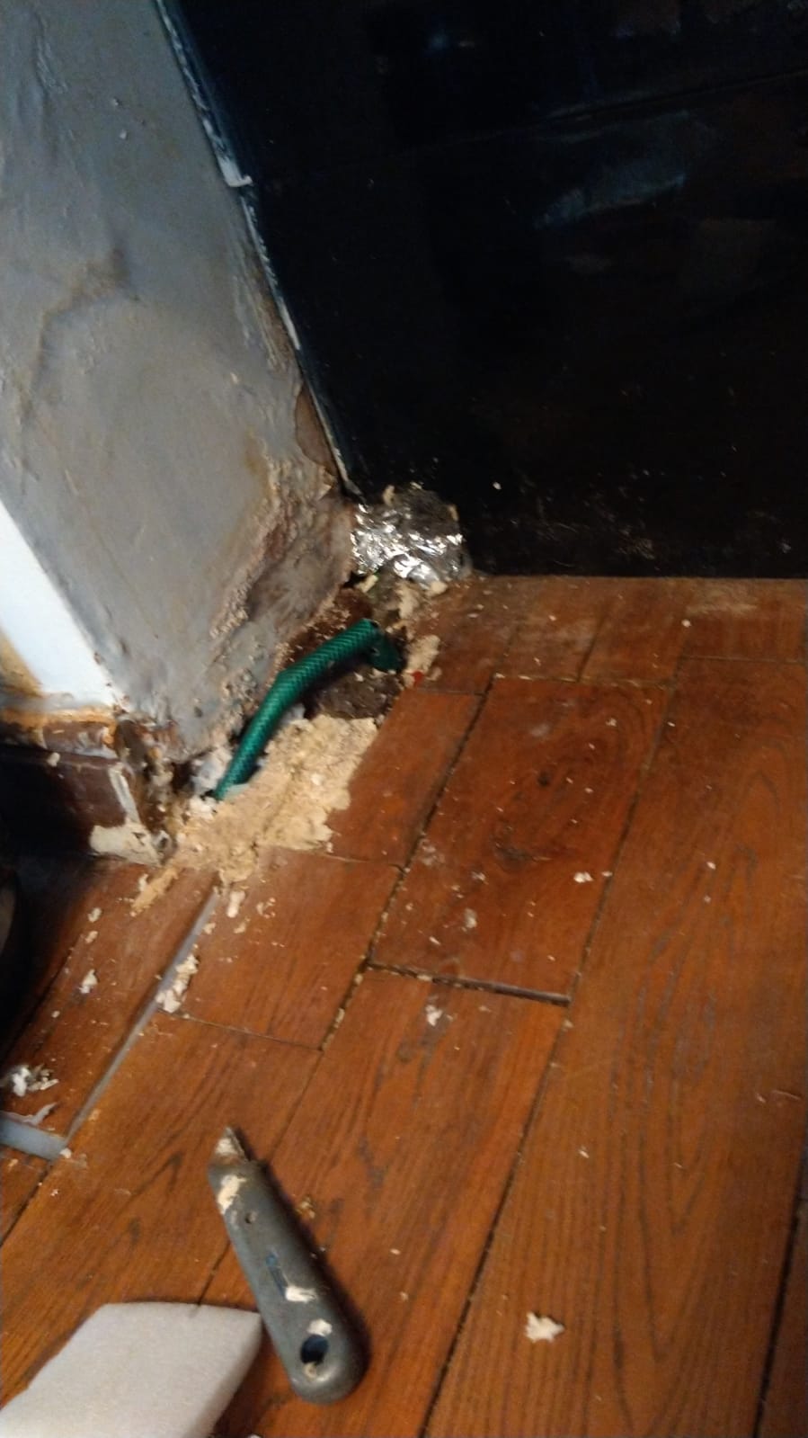

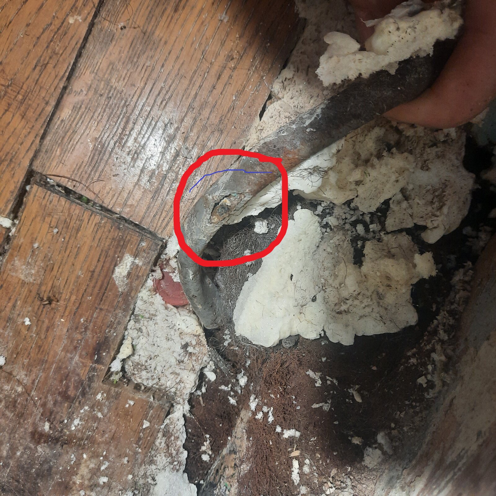

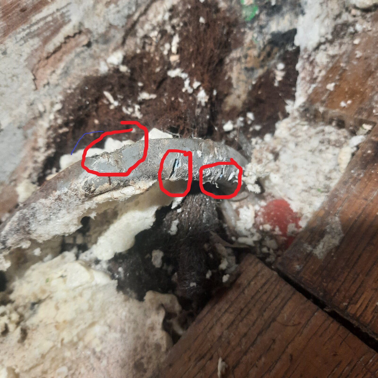

I discovered further problems when I went to visit her this weekend (BTW the property is in Uxbridge). This cable was sticking out of the floor under the breakfast bar - no protection at all. The sheathing is damaged - gouged on one side and sliced in two places on the other side, not surprising considering where it is.
The landlord turned up this morning (Monday) and cable-tied a length of garden hose over it!!
What is the value of an EICR if these things are not picked up?
