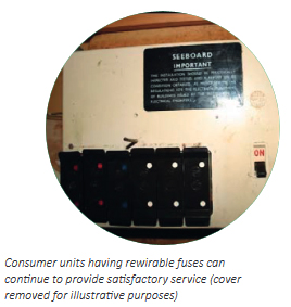

As to RCD protection,
Google said:
BS 3036 semi-enclosed fuses, more commonly known as rewireable fuses, they are still recognised in BS 7671. They may be provided for new installations and may continue to be used in existing installations.
So would guess old Wylex fuse box fuse-box-1.jpg so can't really add RCD protection. As the Electrical safety council says they are not automatic fail, personally I would not want to live in a home without RCD protection, a fusebox 8 module consumer unit with 4 RCBO will cost around £100, and ½ day to fit, the Presence of supplementary bonding conductors, unless not required by BS 7671:2018 (701.415.2) would be satisfied with new consumer unit. Provision of fire barriers, sealing arrangements and protection against thermal effects (Section 527) I will assume some down lights, so not corrected by new consumer unit is likely.

In summary, it's an early 1970s installation that should have been replaced a long time ago.
