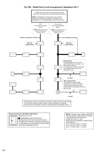

Hi,
We have a garage not far from house that has been converted a few years ago in to a usable room.
We want to put in an electric panel heater (likely just that rather than an oil filled one) and wall mount it.
Found a 2kw one with built in timer and manufacturer supplies it with a moulded plug and says it's absolutely fine to plug in (or permanently fuse spur it).
There is a second consumer unit in the garage installed only a few years ago from the main house board (also new at the time) proper armoured cable etc. It's all been registered as an installation at the council, approved etc.
In the garage there are 3 sockets to one 20amp fuse on the board but I note they have done this as radial rather than a circuit returning to the board, normal 2.5mm T&E used. So it runs to the first socket, from there to second socket and then to third where it terminates. This heater will be on the first socket and nothing heavy will get used anywhere else, no power tools or other heaters etc.
My question please, any issue in plugging this 2kw unit in to a radial circuit rather than a more normal ring one?
Thanks.
John
It all depends on what else is plugged in. 2Kw is about 8 Amps ..............
You have a 20 amp breaker therefor it can power 20 amps, as the heater is 8 amps whats the issue and remeber thats its maximum load, it might draw 8 amps to start with then as it hits temp that will ramp down. As it has a plug why would it not be ok to plug into a standard socket.
No.

I agree, from a letting owners point of view they are a pain in the butt. We have them removed at every EICR. From a landlords perspective when a ring trips that's it, emergency electrician if you can find one, from a tenants perspective lost days work waiting in. With a set of radials any faults the tenant still has other radials working and can keep modern life going.
If we had sockets which could take three 6 mm² cables then we could fit 32 amp radial circuits with ease, however they in the main don't, getting three 2.5 mm² into some sockets is hard enough, so with a radial using 2.5 mm² we are limited to 20 amp, better than in many other European countries which if they follow rules, radials are limited to 16 amp, can't have a 16 amp unfused socket which can take an unfused plug rated at 16 amp with over a 16 amp supply overload.

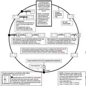

I remember my grandfather's house, with a fuse box full of little re-wire-able fuses, every socket had it's own fuse. The 13 amp plug which except for medical life dependent equipment are always fused, allows for multi-sockets on both rings and radials Ring and radial circuits.pngRing final.jpg with a few rules which need to be followed, and tradition is when we started having multi-ring circuits, the house was split side to side, so with a ring final failure there was no need to run extension leads up/down stairs and both ring finals had a similar load.
The RCD however changed that, since lights split up/down, and we wanted the lights to stay on if some one caused the RCD to the sockets in that room to split, and most consumer units only had provision for two RCD's the sockets needed to split same as lights, so no room had sockets and lights on the same RCD, now with RCBO's we can return to side to side split.
The chance of having two heavy power user on the same circuit at 20 amp is far higher than having three heavy power user on the same circuit at 32 amp, we use the formula when working out likely volt drop, 20 amp centre/end, and rest even spread, so with a 20 amp radial we use 20 amp as figure to work out volt drop, and with a 32 amp radial or ring, we use 26 amp to work out volt drop. So our maximum lengths are:-
Ring final with 2.5 mm² cable and 32 amp overload - 106 meters.
Radial with 2.5 mm² cable and 25 amp overload - 28 meters.
Radial with 2.5 mm² cable and 20 amp overload - 32 meters.
Radial with 2.5 mm² cable and 16 amp overload - 42 meters.
Radial with 4 mm² cable and 25 amp overload - 42 meters.
Radial with 4 mm² cable and 20 amp overload - 56 meters.
Radial with 4 mm² cable and 16 amp overload - 71 meters.
From the above it is clear why we still use ring finals, OK since there and back 106 meters is only a max of 53 meters from distribution unit, but when wiring easy, one 100 meter role of cable must not be exceeded with a ring final. A little more of a problem extending existing, either R1+R2 or the loop impedance / prospective short circuit current as centre of ring final or end of radial needs to be measured, and the volt drop calculated, the radial with 4 mm² cable and 25 amp overload with 0.35 Ω at incomer looking for less than 0.99 Ω at the end of the radial, the 25 amp overload with 2.5 mm² is a problem, as easy to exceed 28 meters.
