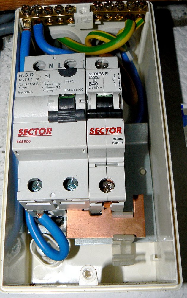

mrcrow - be advised that all of these suggestions are notifiable work:
I guess you could convert it to a b25 if you can get one.
Or convert it to a ring
MCBs are also available in 20A or 25A versions, both of which would be suitable if using 2.5mm² cable.
The shower unit appears to have a spare way for an additional circuit, depending on the rating of the RCD in it.
Remove the entire lot and fit a single new consumer unit for everything.
Hadn't spotted that spare way! See if you can get a 25A mcb for it. (may not be easy!)
I guess you could splash out on some 6mm cable and use a genuine 32A sector MCB.
hardly worth the trouble changing blue to yellow for that items you intend to run off it. Less than you currently have?!
A bit of effort to terminate 6mm cable into sockets. But if you aren't having many...
I think 4mm can also be used with 32A ?
could i get away with 2.5 and a 25A
Yes, no need for 6mm².

Andy...would i be able to use a 2.5 t+e and a 25A mcb?
EFL...ditto...but both...i will stick with 4 if you think that is best..

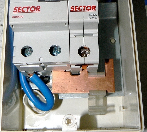

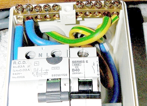

ps that space isnt much room to get a mcb in...looks like i will have to take the bus out?
** i do notice and from other examples of installing a mcb that the grey insulation isnt present...that means with 2.5 for example it would seem to be more room available

2.5mm and 25A is fine.
Yes the bus bar needs to come out.
May need a new hole in the right side for the cable.
Shower looks to be done in 10mm

2.5mm should be rated at 27A when clipped down (from memory)
So choose an Mcb lower than 27
Hence me saying 25
I was just thinking you could use cost to help decide.
B25 £9 + 2.5 mm cable
B32 + 4 or 6mm cable
