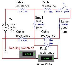

It sounds like you have a N-E fault of some impedance, which would cause the RCD to trip as more load is introduced.
First I will try to explain the earth neutral fault
The picture is taken from an electronics program and every wire I have given a resistance of 1 ohm as all wires have some resistance and the small faulty item 3900 ohm with the large item which I have given a value of 2000 ohm switched off the ammeter recording the fault current is below the 0.030 A which will cause a RCD to trip. However when the switch is closed the extra current drawn lifts the fault current to over the 0.030 A so the RCD will trip.
It is this that makes it so hard to work out what is making a trip open. Now wet plaster is likely to conduct some small current which could make a fault become apparent when any load is put on the circuit. The leakage is so small it really needs a special meter that uses 500 volt to find this fault so likely you will need an electrician.
The electrician you have had working for you should have provided you with a schedule of test results and the new electrician using these will quickly be able to locate where the change is and so where the fault lies.
