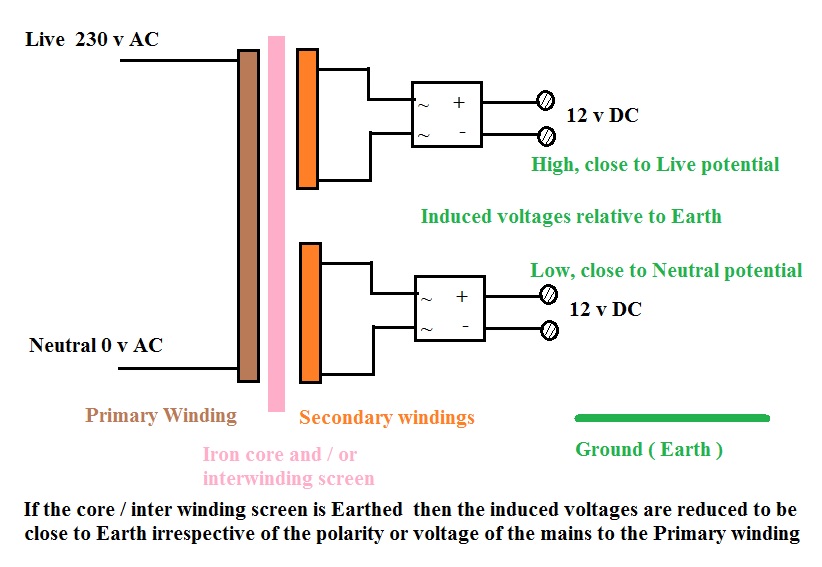

When a device is supplied by mains without an Earth then the mean ( average ) potential of all the circuitry will be somewhere between Live and Neutral.
Am isolated 12 volt DC output from the device will ( should ) have 12 volts between the two output terminals but they will have AC potentials different from Ground ( Earth ) potential. The AC potential is induced by capacitive coupling and thus is a high impedence and unable to supply a significant current. The AC potential will depend on how the devce is built and which way a reversible mains plug is inserted.
This applies to a magnetic wound transformer and shows how the induced voltage relative to ground is affected by the arrangment of the windings on the transforner and the stray capacitive coupling between them.

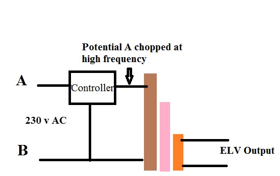

In the case of an SMPS ( electronic transformer ) there is a high frequency transformer the secondary of which will be close to one side of the incoming mains supply.
If B is Live then the induced potential of the ELV output will be close to Neutral. If B is Live and A is Neutral then the the stray capacitive coupling between the windings will induce a mean potential on the ELV output that is close to the Live potential above ground.
Of course, neither of those illustrations are representative. You would not find a standard transformer with a linear wound 230V primary - the windings are always layered.
On the SMPSU, you would not get away with a completely floating ELV output - there are always some components between the two sides of the transformer to allow the common mode currents to be coupled back to the primary side.
If the bottom layer ( closest to the core ) of the primary is the Live end then the top layer of the primary is at Neutral potential. If the secondaries are wound on top of the primary then the secondaries are closer to Neutral than to Live.
