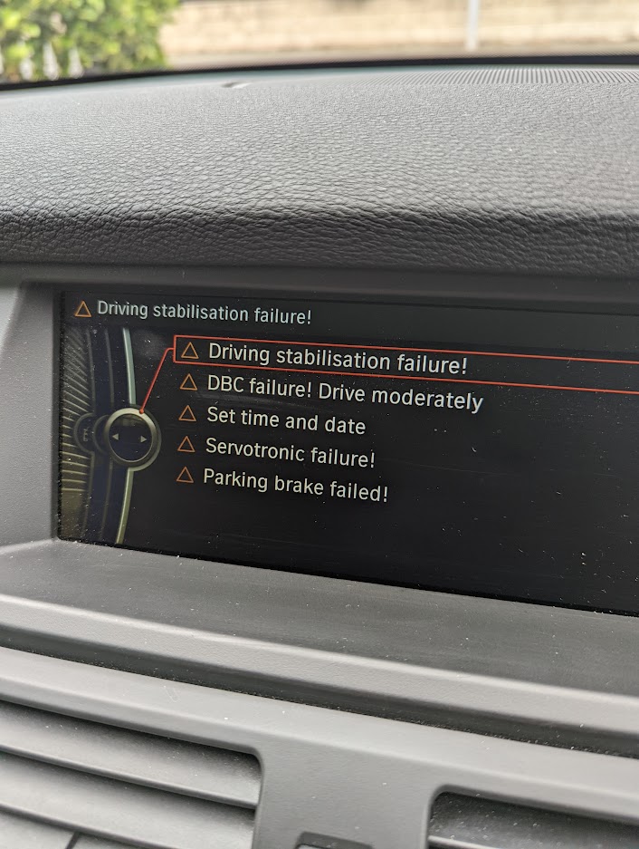

Electronic parking brake failure

I just tested the battery with a multimeter and it's at 11.79 v
Is that the problem?
Should I buy a charger and try charging it first before buying a new battery?
Should sit around 12.4 to 12.6 so it does sound suspect.
Need to confirm there is not a drain and/or that the charging system is working fully. Could just put a new battery on and hope it cures it (likely) or have the system checked to be sure
Okay so I just fitted a new battery, it's showing 12.47v is that normal for a new battery?
I now have even more error messages showing up!

Just noticed that the battery they sold me is a wet battery but the one I had was an AGM battery, is this a problem?
Also the new battery is 110Ah but my old one was 105Ah
Should I take it back?

12.47 is low but acceptable. Should increase to around 12.6 after driving and charging. It has probably sat for a while to be at the lower end of tolerance.
Yes, if. If the battery type required should be AGM which is what i,d expect in x6
