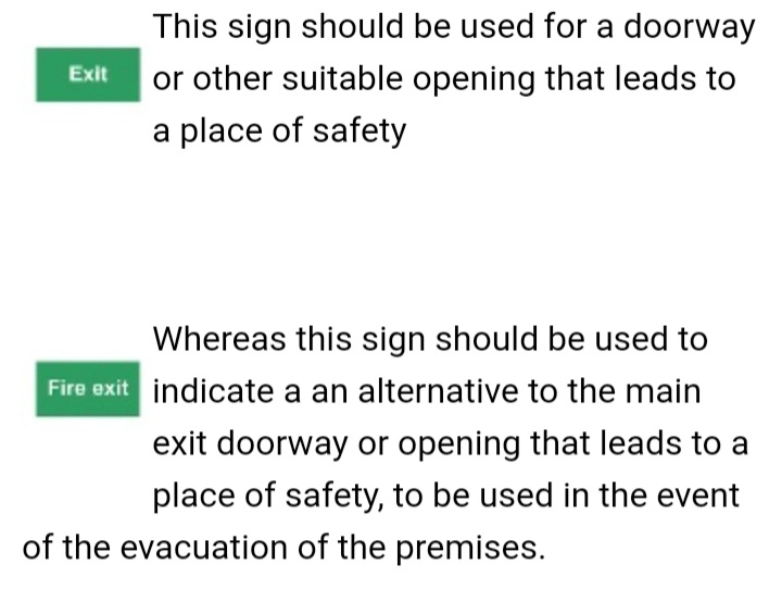

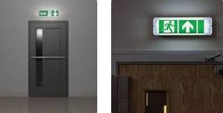

As per the title, which is the correct orientation of the arrow on an emergency light above an exit door, up or down?
I frequently see the top two above a door, one being an unlit sign t'other being lit.
The site linked to and quoted by random grinch is wrong, for a start text only signs have not been compliant for about 30 years.
Of the two pictures in the OP the left/first shows an original BS5499 format style sign, while the 2nd/right shows an ISO7010 style sign which is very similar because 7010 was based on BS5499 and then later most of it got re assorbed into an amendment of 5499.
In between we had the euro stylo signs (showed the man and the door way as separate symbols) from about 1996, but no longer prefered.

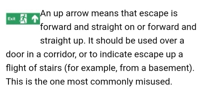

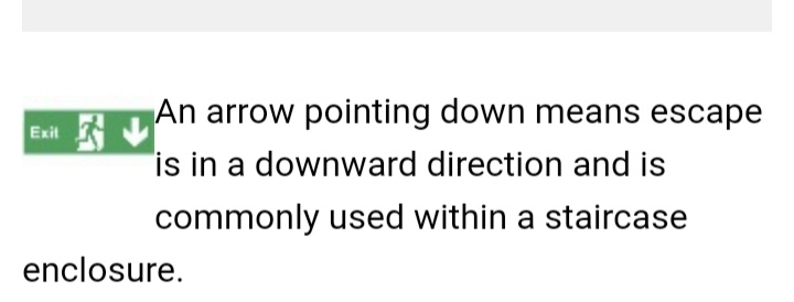

traditionally we used a down arrow to mean proceed through/forward although not explictly defined. ISO 7010 however states that an up arrow should be used for proceed forward (down arrow only used where you need to descend). BUT... you shouldn't mix and match within the same building, if you replace an exit box where every other exit box is pointing down for 'go through/ahead' then thats what you should fit, even though you wouldn't if it was a new job (consistancy and avoiding confusion being more important than meeting the latest style) You also shouldn't really mix and match standards in the same building, but generally thats not possible and most settle for not mixing arrow meanings in the same building

We always used up for forwards...
Until we joined the EU, as the common market morphed into, and the French (who had always used down for forward) decided our format was too confusing for them when visiting and an EU wide format was created...
