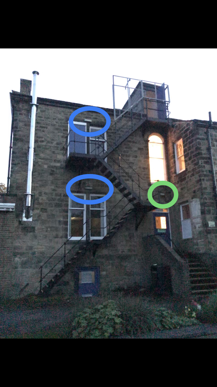

I’m currently rewiring one section of a community centre. To the rear of the building is an external fire escape which is served by two doors from the building.
The lighting in each room where there is an escape door is supplied from a different distribution board.
I am proposing to install four external fittings to light the staircase. One above each door, and two on the longer lower section.
Would you prefer the lights to be fed from a local circuit per floor, or all from one circuit only? If only one circuit, which would you use?
Here’s a picture of the fire escape with the two doors circled.

This has given me some good ideas. Currently the only lighting on the fire escape is provided by two 8W fluorescent bulkheads which you can just see in the picture. One above the door on the first floor and one directly below above the first floor window. There is no lighting at all for the second floor exit.
The existing lights are switched by a two way switch, one at each door which provides a 230V AC switched supply to the lights, and the emergency supply is 24V DC from a central battery located in a remote part of the building fed from a different dist board on a different phase, so obviously not ideal. The 230V electronic ballasts do not function so currently there is no light at all on the stairs unless there is a building wide power failure.
I’m wondering if to try and re-use the existing switching arrangement or if a photocell would be better?
I had been thinking today that standard LED self contained bulkheads would not actually throw much light at all onto the treads. Is there a more suitable fitting?
I’ve been thinking about using standard bulkheads mounted on L brackets so all the light is projected down onto the treads just to try and keep costs down.
Thanks for all the replies so far.
I’ve circled the existing emergency lights in blue. The light circled in green is just a standard outside light with no emergency supply at all, so this staircase is not protected.
Also the cellar door has no lighting at all. It is not a designated fire escape but it really needs to be as it is the only other escape from the mains and boiler rooms other than the main internal staircase.
