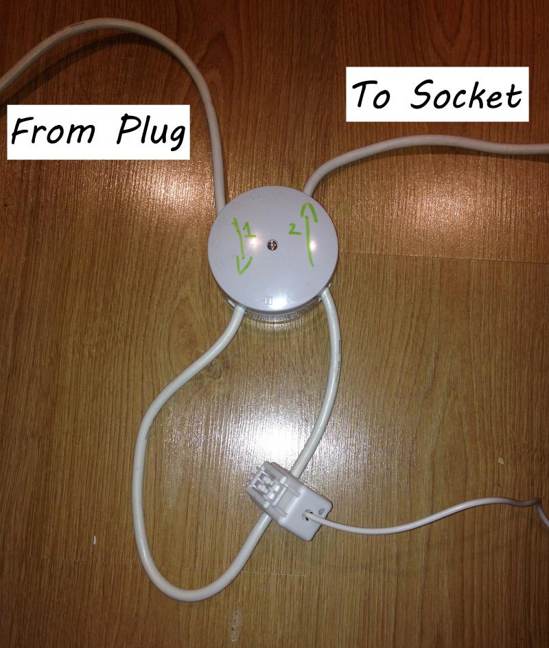

I made a energy test jig yesterday to allow me to easily measure the power of individual items. The photos below show it. :)
(Current flows from plug, through the loop section and then to socket; the neutral bypasses the loop and goes straight through JB.)
What I can't work out :oops: :?: is why when their is a loop through the clamp as shown in the second photo, the meter reads nothing but when it is a straight pass through the clamp it works fine.
Been a long time since I did anything to do with magnetic fields and electrical currents at school, but if I remember correctly they pass each other at 90 degree angles, although don't suppose that has anything to do with it.
I incorrectly assumed that it would see twice the current because the current was passed through it two times, but somehow I guess the magnetic fields from each pass through the clamp are canceling each other out.
Not sure why they would cancel each other out when the current is flowing in the same direction, but am guessing either it has something to do with the direction of the magnetic fields or some sort of inductance/capacitance effect.
I would be most thankful if anyone who could explain what is happening and illustrate it.

With two passes through the sensor you should be reading twice the value that a single pass produces.

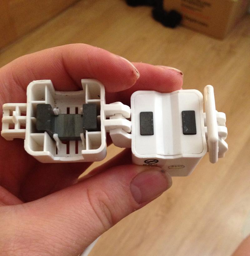

Check that with two passes that the clamp is fully closed and that the faces of the magnetic core are touching each other. Even the slightest gap in the magnetic path through the core will reduce the reading to a value approaching zero.
Also, your clamp is round the whole cable. This will have the line, neutral and earth conductors in it.
For it to work properly, you need your clamp round the line conductor only.

it would be interesting to see what's happening inside that junction box
I think it's fairly obvious from the OP's description, isn't it? ... N and E go straight though (from 'socket' to 'plug'), whilst L goes from 'socket' to 'plug' via one of the cores (or maybe 2/3 cores in parallel) of the 'loop' cable which goes through the sensor.

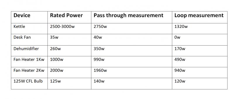

Firstly I know the energy clamps are not accurate, especially at low loads, but I built the jig simply because it was what spare bits I had laying around (including the clamp style energy monitor) and I just wanted to experiment and see what sort of results I would get from it.
If I had an individual plug in energy monitor like BAS showed, then I would have used that of course. (And yes, I keep meaning to buy one.)
Also I based my initial results on a 35w desk fan, but I have now tested my rig with several devices of various power ratings and the table below shows the results. Note I kept the clamp setup the same for all the loop measurements and pass through measurements respectively. The loop of cable was also very tight in the clamp in the loop arrangement.

Also the clamp is the Owl CMR130, see the photo below.
