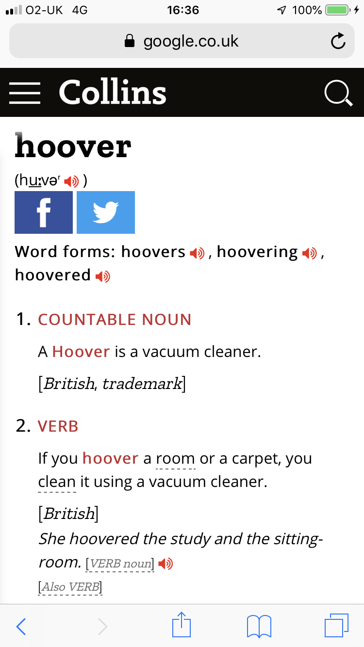

Double negative to my mind (well, not a conventional double negative, but I'm sure you know what I mean!)
I would say that "Neither Henry nor Hoover are anything to do with each other." is just plain wrong. Acceptable (correct) alternatives would presumably include:
Neither Henry nor Hoover are is anything to do with the other.
and
Henry and Hoover do not have anything to do with each other.
Kind Regards, John
Edit: oversight corrected - thanks to EFLI for noticing!

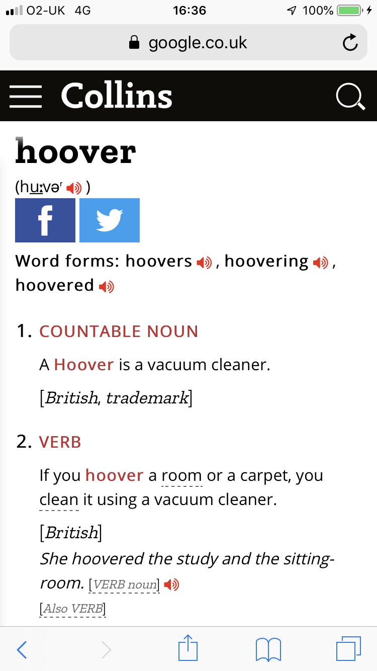

I would say that "Neither Henry nor Hoover are anything to do with each other." is just plain wrong. Acceptable (correct) alternatives would include:
and
