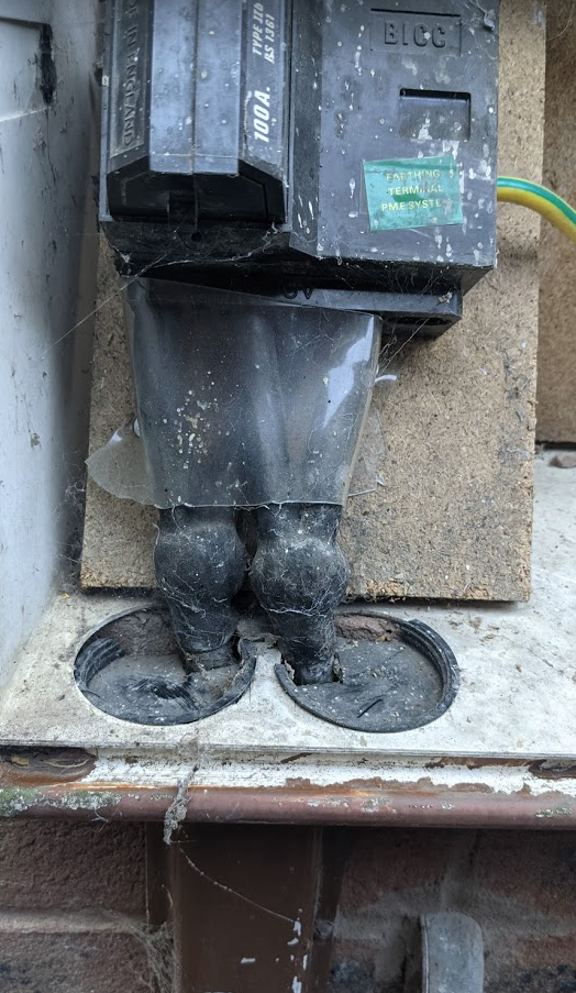

Hi. Planning on speaking to the DNO tomorrow just wondered if anyone has any experiences of having a looped supply AND a 100A service fuse? I've googled about but cant seem to find if the installer would want a dedicated supply to install a 7KW charger. All the examples I can see is with a looped supply and 60A/80A Fuse, which do need "un-looping". Thanks.
The 100amp on the holder indicates the maximum fuse size. The actual fuse fitted may be 60 or 80 possibly 100amp.
ask the DNO when you call them.
As far as I’m aware, regardless of fuse size, an EV is not permitted on a looped supply, of any size.
Certainly in my area, Western Power will ‘unloop’ the supply for free

There’s a few ways that they can do it. I’d leave it to your DNO to sort, they can deal with all the arrangements with the neighbour.
They must have been some of the last to be looped, not a permitted practice anymore, definitely haven’t come across any fitted later than around 1998
They can open your garden and joint to the looped feed to the neighbour, not disturbing their garden. It will be a trench in yours to the main in the street.
They are obliged to do it for free if your installing EV, but they obviously reclaim costs through the government’s initiative.

Both PME and looped the only person who knows 100% is the DNO. One is with some contracts obliged to inform the DNO when some loads are applied, welding sets for example, but each DNO it seems has their own rules, so you tell the DNO what you are doing, and what they do is down to them.
DNO contacted and the supply will have to be un-looped. According to my installer the DNO also stated that the supply will have to be un-looped before the install takes place and they will not accept using a load balancing sensor or charger on a lower setting while waiting for the un-looping to take place.

If the 'looping' is directly between the two buildings (rather than going through the OP's garden), I would think that 'disruption of the neighbour' could only be avoided if the supply to the neighbour continued to go through the OP's house (via existing service head), with a totally new supply from the main to a new cutout being installed for the OP's house?

depends how the ‘loop’ part is run. If it goes back out the house and into next door then, it would be cut near the house and jointed to a new cable from the road. Or even near the boundary to avoid disruption to the neighbour. but yes if it runs internally to next door (terraced house or back to back in a semi etc) then the only way would be to resupply the neighbour
