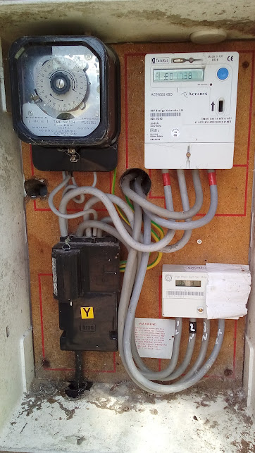

I think the rules change as it's convenient, This pic was the supply for purpose built corner shop whic has now been converted to 2 flats. There is another box looped from the adjacent building which is for the accomodation above. There are 3 charging points on the building, 2 of which are on this box and the other is on a looped supply.

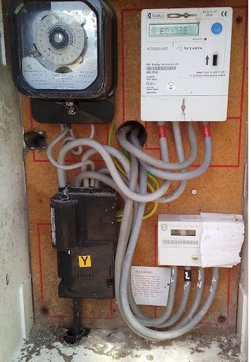

I have seen mostly as described, terraces and back to back under the stairs usually in semis
Have also seen three together on one loop, where they looped through the front gardens, in this case not sure why they didn’t take each cable back to the road
have also seen houses looped in pairs where they had longer front gardens to avoid long runs for each house
The weirdest I ever saw was a house fed from a main across the road, the service cable passed by a streetlight and into the house. The streetlight was fed in 4mm straight con, but was looped out the bottom of the cutout, literally the furthest it could be from the main. Only thing I can think it was to avoid another joint for the streetlight. In this case the supply was being moved so the streetlight just got jointed to the cable to the house where it was cut to the extended
