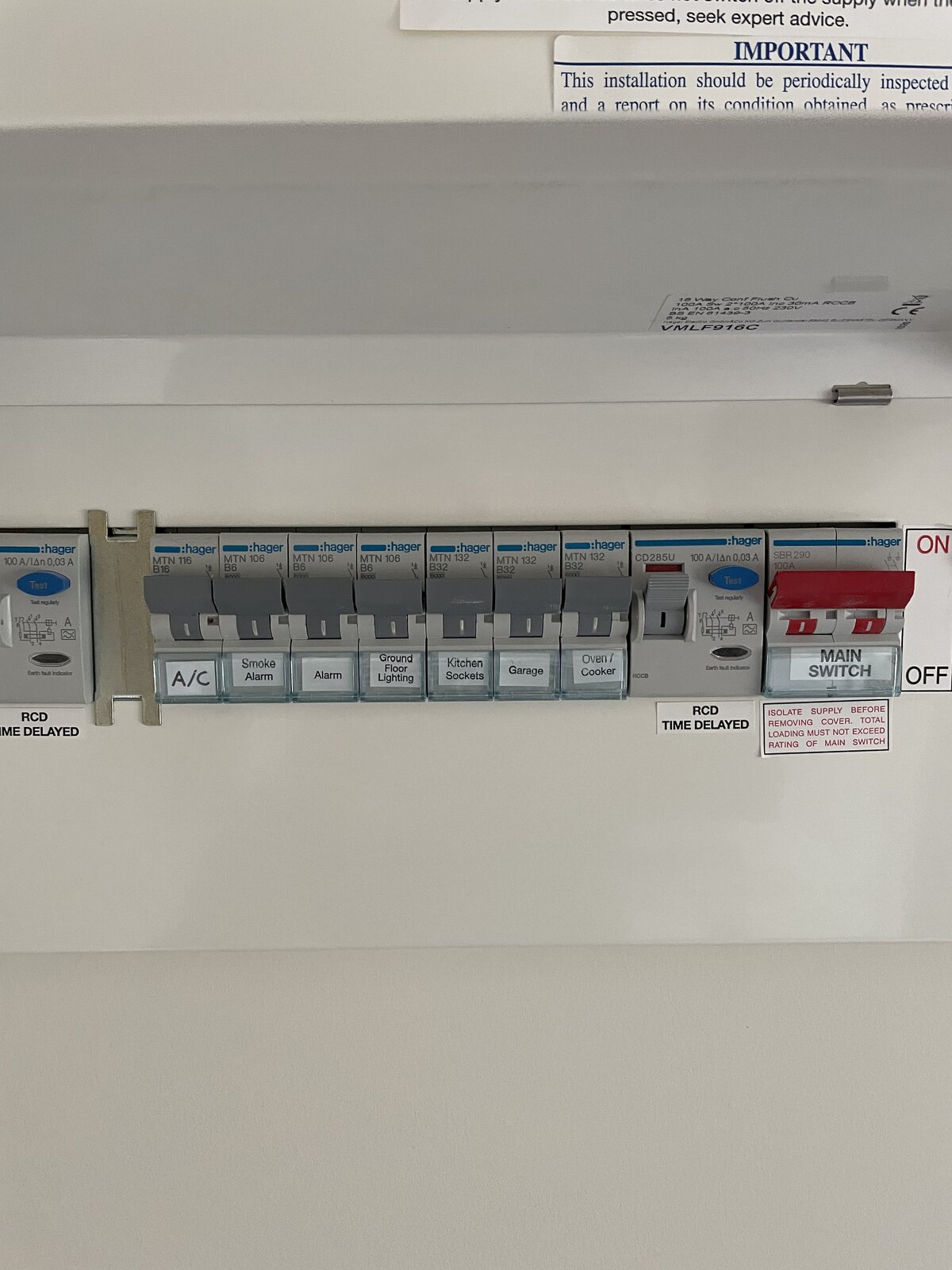

The pictures of the CU got me puzzling
I though to myself.TIME DELAYED RCDs??? They would not comply to meet the disconnect requirements for the installation if they were.
So....I looked at the spec for the CD285U RCD. These are not time delayed devices. The RCD would have an "S" mark on it.
You should cut off the words "Time Delayed".

These were attached when the the upgraded cu was installed. I will adjust the stickers so there is no confusion.

The fact that they're 30mA would immediately indicate that they aren't time-delayed (S type).
Not so. 30mA Time Delayed RCDs are available. Eg https://www.electricalcounter.co.uk...e+Pole+Type+A+30MA+Time+Delayed+RCD/759346069
Not quite sure where you might use one though…
Yes, I came across similar a little while ago but, like you, struggled to think of where/why one would ever use such an animal. The only situation I could think of would be as an up-front RCD on a TT installation in which all the final circuits were protected by 10mA RCDs/RCBOs - but that would surely be an incredibly improbable scenario (if it ever exists at all) ?
Can you (or anyone) think of any other situations in which such a device would be approviate?
