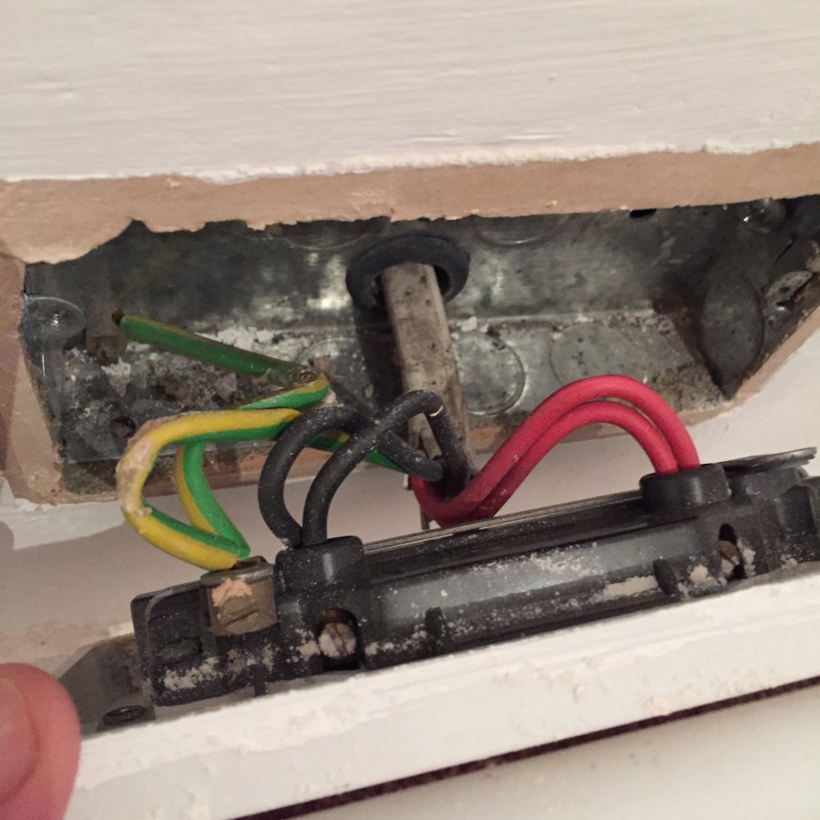

You say this 60s hose has had a 'modern rewire', so, depending on how new the cables may be, it may or may not be a waste of time rewiring all of the circuit.
I suppose a good indication would be whether the cables contain red and black or brown and blue cores.
Brown and blue wouldn't be any older than 11 years (assuming it is proper T&E cable, as it almost certainly will be) so really wouldn't need changing unless badly done.

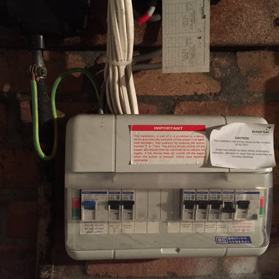

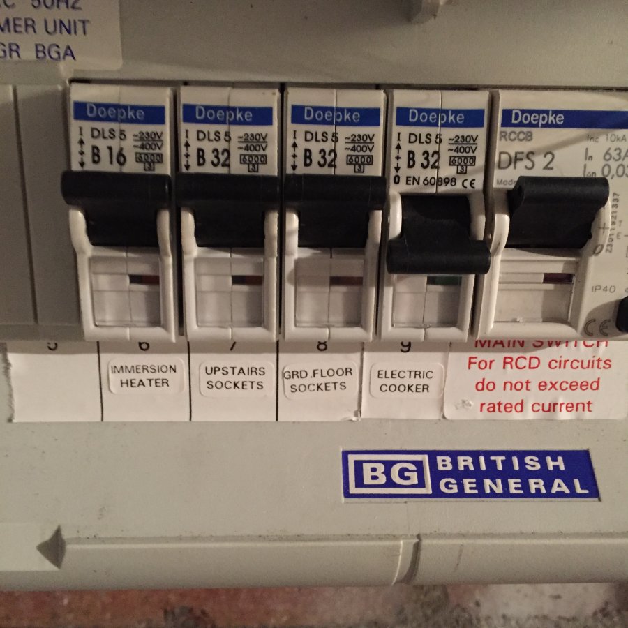

Photographs would be most welcome, out of general interest.
Yes, please do.
It could well be that your 60s house wasn't rewired, merely 'upgraded'.
Photos will tell us a lot.
